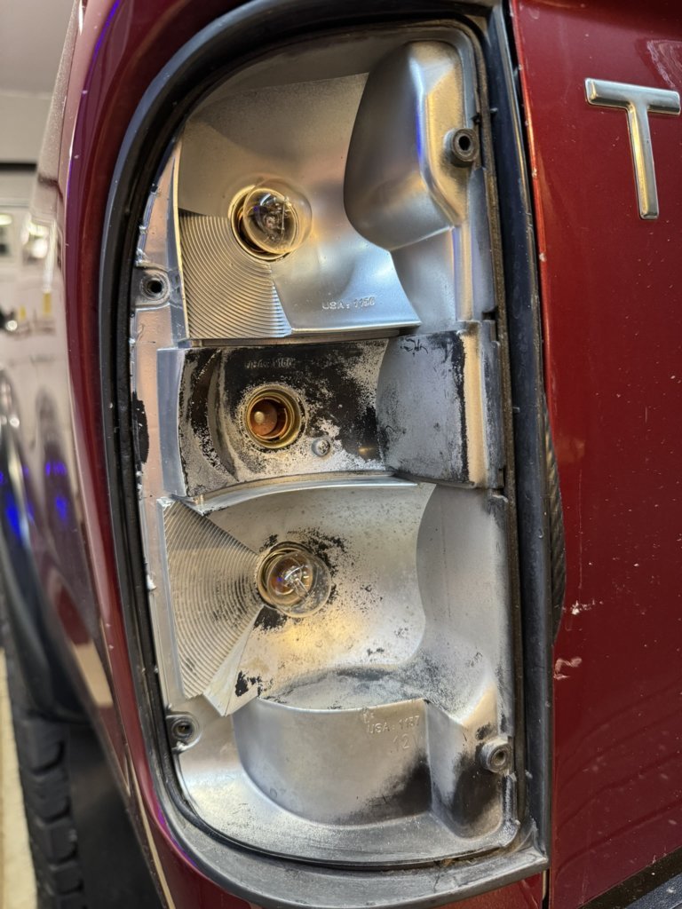

    The reflective paint on the inside of the taillight housings on both sides are flaking off, with large sections showing the black plastic behind it. I'm wondering if anyone has repainted theirs with a new reflective paint or material - and if so, what was used / how'd it turn out?

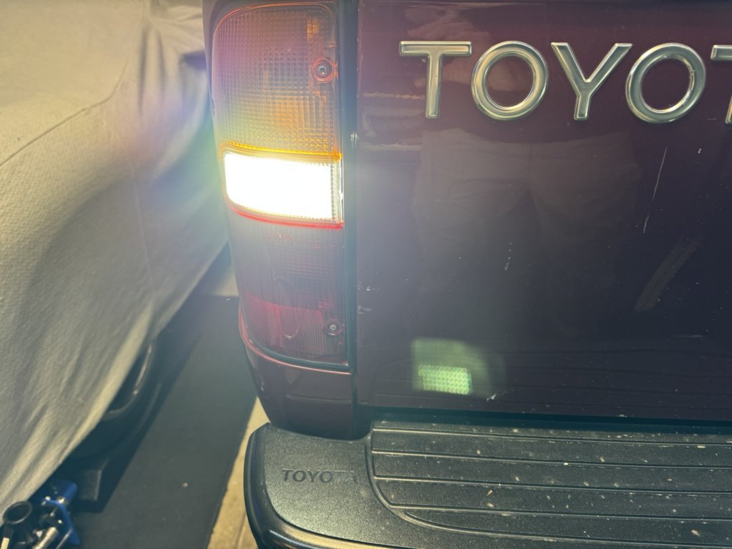

    Capt Pie
    Capt Pie [OP] Well-Known Member
    Sep 20, 2010
    #43520
    75
    sacramento
    sr5 V6 4WD

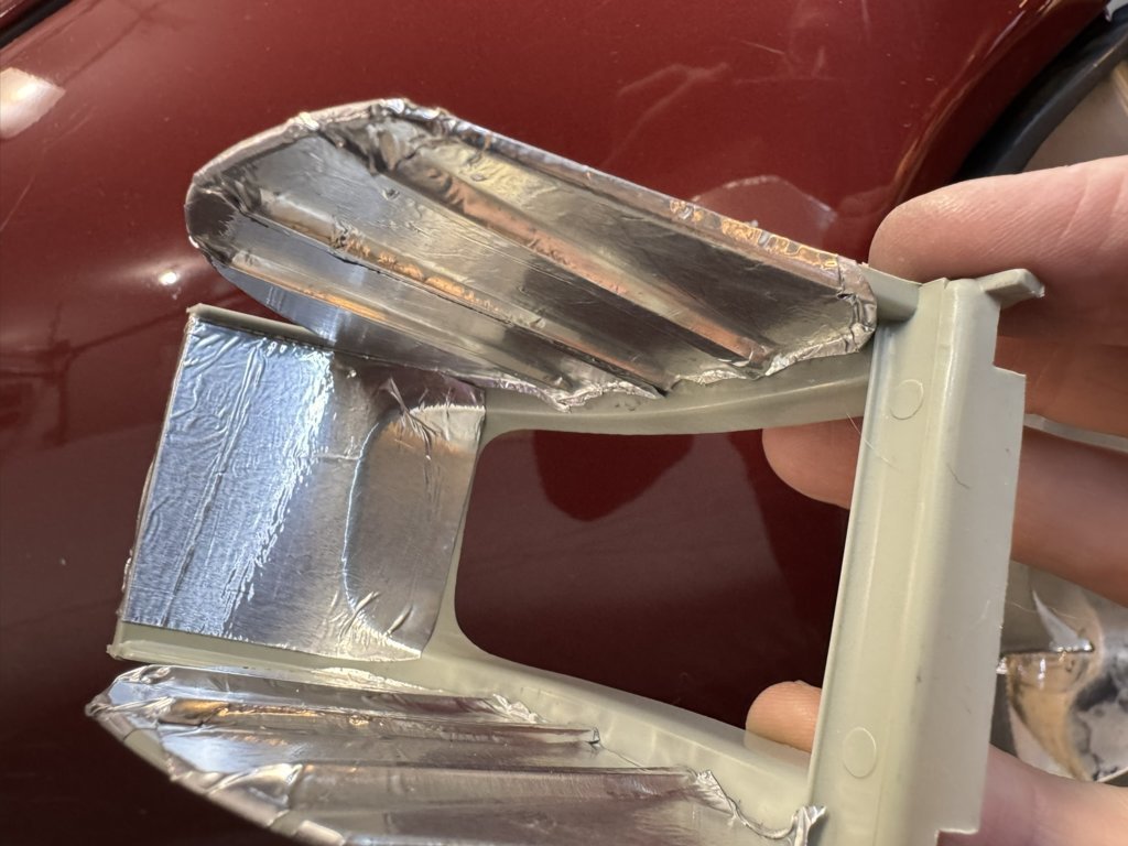

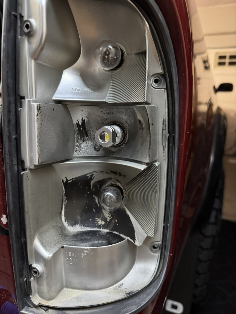

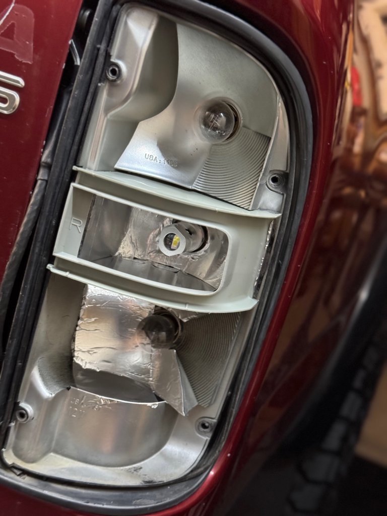

    While I wait for ControlCars generous shipment to arrive, I figured I'd at least try the tape route since I had a roll here already. I tried to make it as clean as I could, but I'm not great at arts and crafts. I think my 4th grade teacher, Mr. Bradley, would give me a C- on it. But hey, the lens will be covering it.
    The result was me needing to squint while it lit up my entire back yard. I need to figure out a way to be able to toggle these on without needing to be in reverse for trailer loading and unloading.
    LH before
    RH Before
    RH After
    Reverse housing bling
    Next is to figure out how to wire a manual reverse light switch to use for loading and unloading our bikes.
