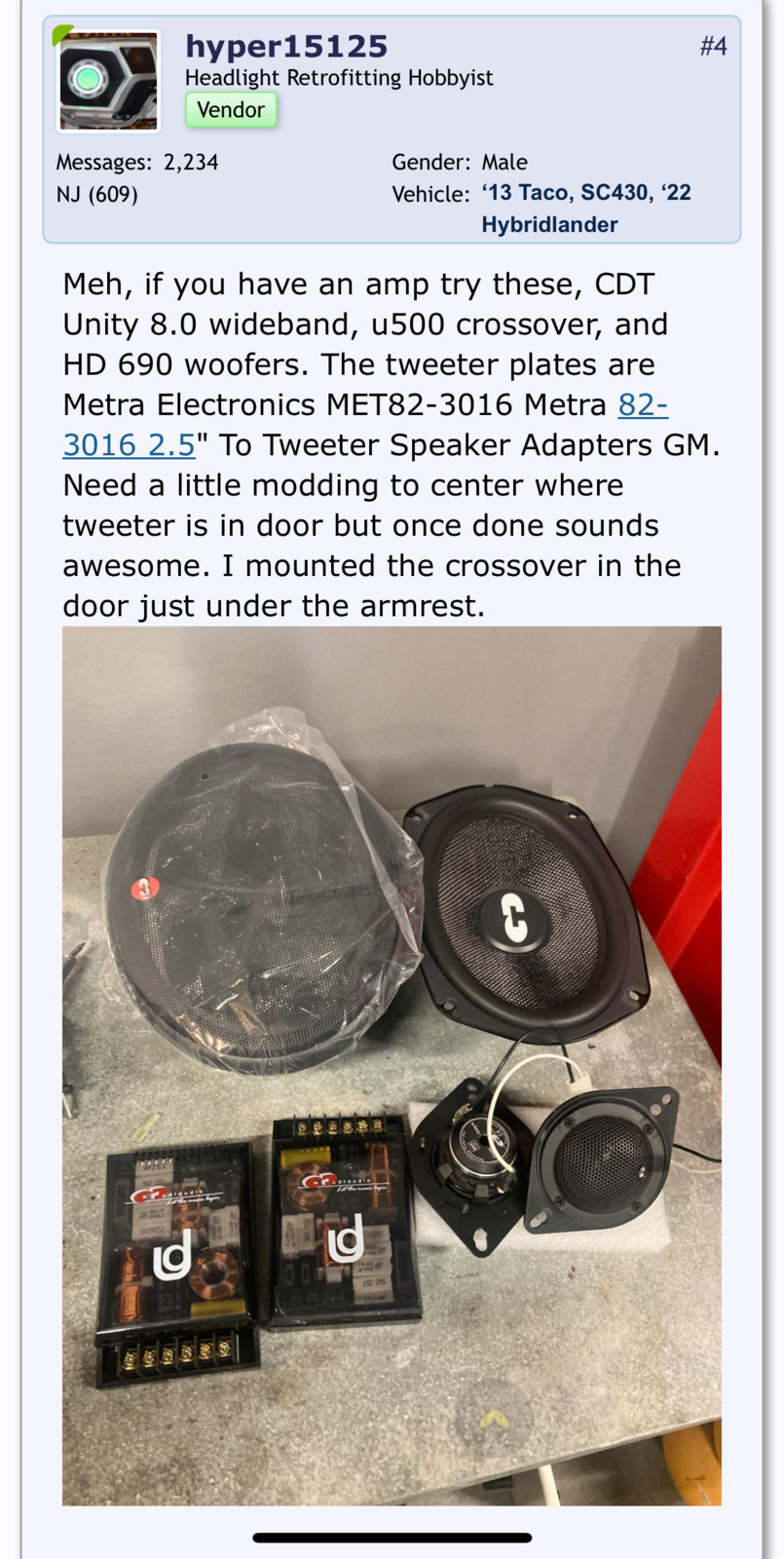

    @hyper15125 is running CDT's. Maybe he can answer some questions for you.
    sublimaze[QUOTED][OP] likes this.
  13. Mar 15, 2024 at 2:26 PM
    hyper15125
    hyper15125 Headlight Retrofitting Hobbyist Vendor
    Feb 11, 2015
    #148420
    2,235
    NJ (609)
    The CDT’s are awesome. The wide bands are something else they really bring the soundstage upward. Also, the only speakers I haven’t blown yet.
  14. Mar 15, 2024 at 2:45 PM
    MGMDesertTaco
    MGMDesertTaco Come on, live a little...
    Jan 30, 2021
    #354573
    9,736
    What amp were you running with those? I think it was around 75w-100w rms?
  15. Mar 15, 2024 at 3:15 PM
    hyper15125
    Feb 11, 2015
    #148420
    2,235
    NJ (609)
    Alpine PDX-V9. Birthsheet said 128x4+582x1

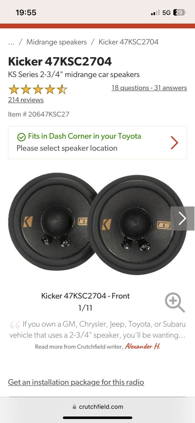

  16. Mar 15, 2024 at 5:56 PM
    #16
    Stevie17
    Stevie17 Well-Known Member
    Mar 2, 2023
    #419202
    4,218
    Stevie
    Crossville, Alabama
    24 Celestial Silver Sr 5 DCSB 4x4
    I’m using these in my dash with bass blockers and they sound awesome. IMG_0467.png
