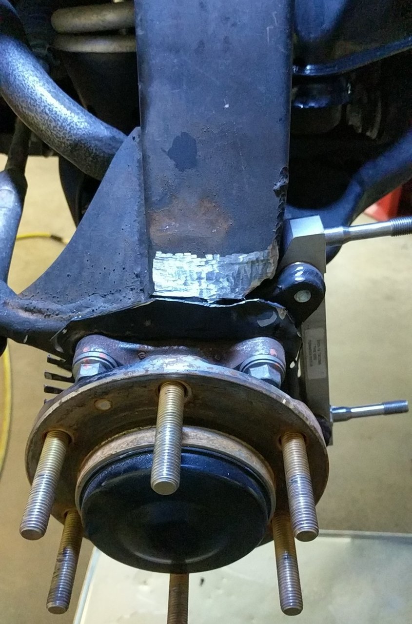

    I had to cut the backing plates first which was no easy task. They are thick, and you have to get the sawzall in some tight areas. It took me about an hour per side to finally get those backing plates off. Then I had to grind down the bottom of my Spindle gussets to clear my front discs: IMG_20180127_094233.jpg this was right before I started grinding so you can see the rub

    eeek :/...yeah those spindle gussetts were not installed correctly. I used a plasma cutter so my backing plates took about 30 seconds to remove :)

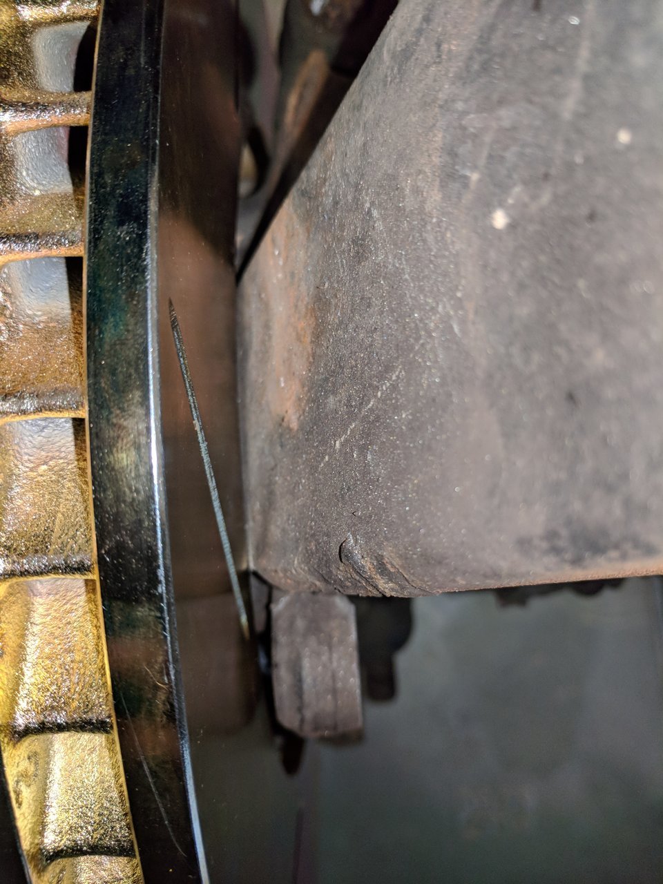

    How were they supposed to be installed differently? These are total chaos spundle gussets, they come with a warning about brake clearance but I just said screw it and cut into them because the area where I took material off was not technically load bearing

    IMG_20180206_220931_01.jpg this is after cutting before I painted it with rust protectant. Not that the rust protect will do that much but better than nothing I guess

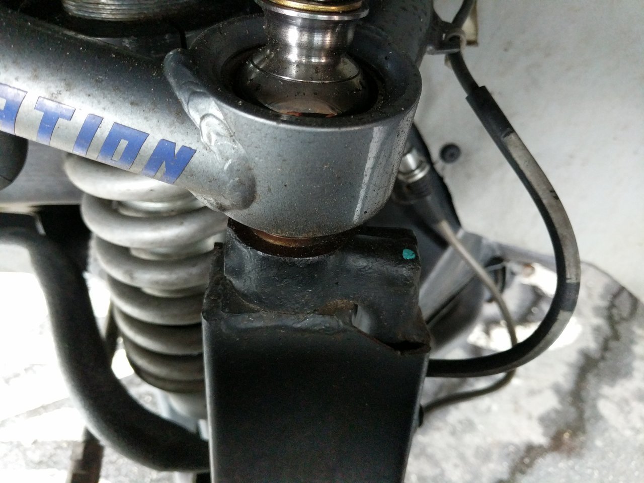

    Take a pic of the top portion of the spindle and gusset. My assumption is that the gusset was aligned too low on the spindle ?

    I was not supplied said spacers... I figured a little more cooling find can't hurt haha. Here's the top portion:15195744587013972782763894249104.jpg

    hmm weird, are they TC spindle gussets ? that top alignment is correct so I don’t know why you have that problem at the bottom...unless your rotors have a smaller ID ? I just have the Stoptech 4 piston front calipers which is a size smaller rotor so maybe the inner diameter of tour rotors is smaller which puts it tighter to the spindle ?

    Could be. They ARE TC spindle gussets. These are also aerorotors, which could be the difference. They are two piece rotors and I'm sure some of the dimensions are a bit off stock rotors due to the material difference in the hat... Either way it wasn't too bad as you can see in the picture it was mainly just the one corner I had to grind down a good bit.
