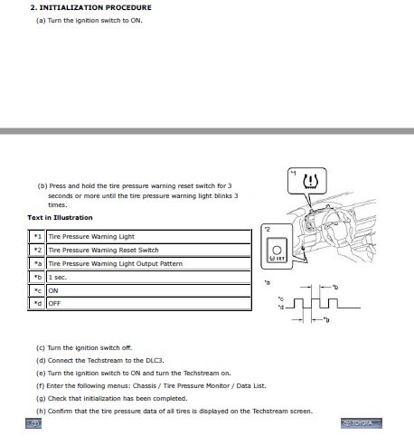

    The TPMS ECU can only receive four at a time.
    It IDs when:
    (1) Using the Techstream, manually enter the tire position for each transmitter ID.
    (2) Perform initialization to clear the existing tire position information, then drive the vehicle at 37 km/h
    (23 mph) or more for 10 minutes or more until each tire position is automatically identified.
    (3) Without performing initialization, drive the vehicle as normal until each tire position is automatically
    updated.
    Initialization procedure:
    ID relies on wheel speed sensor communication from the Skid Control ECU and acceleration rate from the TPMS :
    Here's what I'm thinking...
    You might be able to use an ID cloning tool to clone an existing TPMS sensor.
    It would remain unread until it's rotated in and acceleration rate is picked up by the TPMS ECU.
    Clone tool PDF:
    http://www.bluestreak.ca/media/1320/e446_digital-resources_tpms-cloning-tool-manual.pdf
    Might have to wrap your tire in aluminum foil...:cookiemonster:
