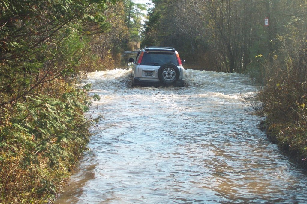

  18. Jul 6, 2025 at 12:57 PM
    #18
    Junkhead
    Junkhead TRDude
    Feb 27, 2019
    #284671
    15,685
    Serge
    Prince George, BC
    Black 4x4 Sport MT 2018
    Some Serious Tires
    Ive done quite a few deep water crossings and had zero issues.
    Once i had water over the corner of my hood for about a second.
    I honestly think its not necessary as well, unless one is an extreme offroader but 3Gs tacos are not designed for constant deep water crossings.
