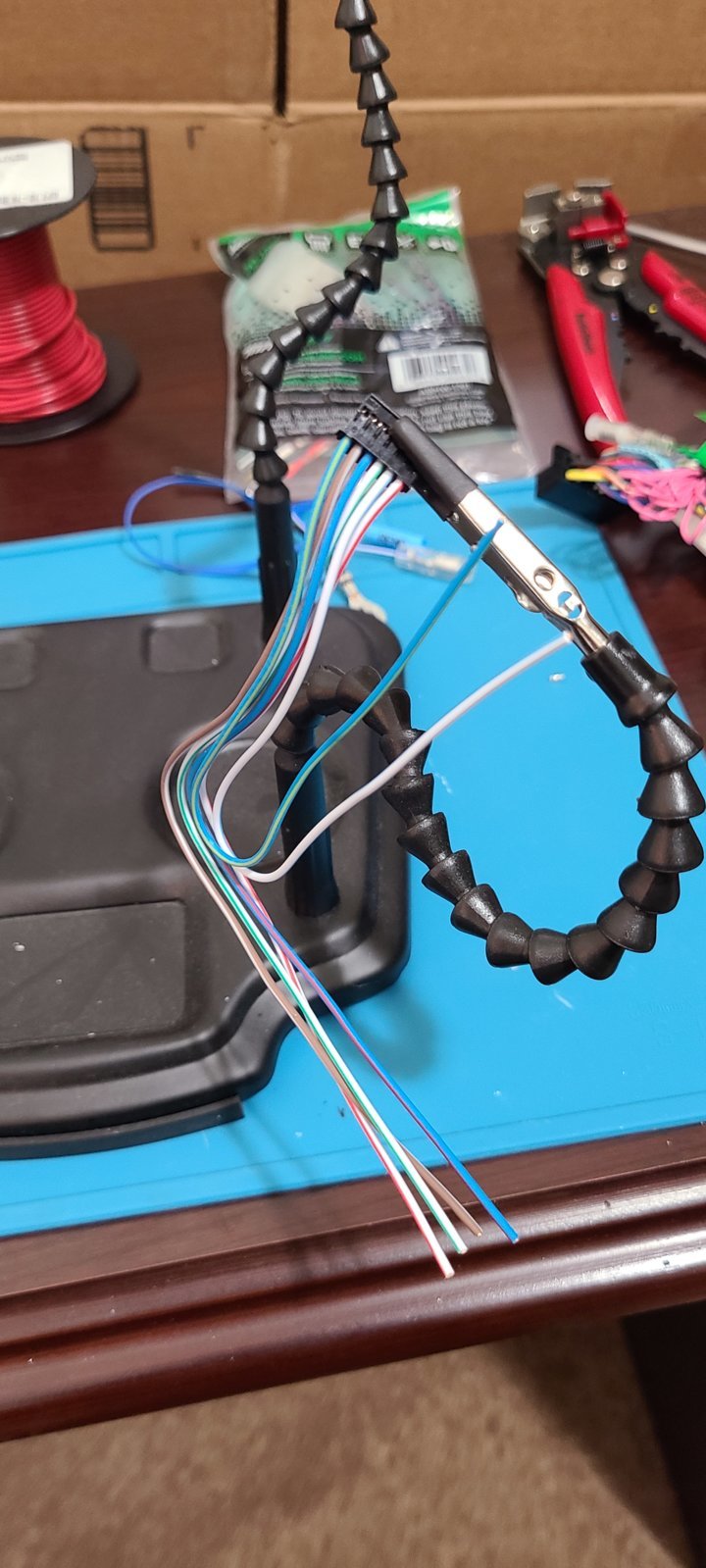

    Got the alpine F511 installed and the RR2 is working. The programmable output works! I used the Drive Gear for the trigger and the Toggle option. I left everything else alone since I didn't need a delay. Since the tacoma uses negative voltage to apply the locks, I didnt need to convert the negative output signal from the RR2. I just tapped into the door lock master wire at the kick panel.
    It's super fast. The lock engages as soon as my shifter hits the D gate. It doesn't even wait until it's fully engaged.

    So the RR2 comes with a separate 6pin harness for the outputs. Only 3 wires are specified to be output wires. I couldn't find any info on the other 3. They may be something that will be available to use in the future. Only the single trigger wire is needed for the signal. In my case, I used the white/red. The other 2 trigger wires are the white/blue & white/green.

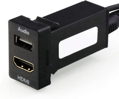

    Wild question - anyone tried to run a USB port out the dash for reprogramming a Maestro?
    I'm not just talking about leaving a USB cable tucked behind the dash, but actually using something like this dash mount:
    Here is what I am thinking - the DMX1037 has an HDMI port and single USB port. This was the only way I found I could run the HDMI port to the dash (if anyone has another answer, I'm all ears - not the Batige Cigarette lighter adapter, I don't want to lose the 12v outlet). But i have the cables to use the existing USB port on the dash already, SO.... I didn't want 2 USB ports with one not working.
    Option 1 - wire the USB port for power only
    Option 2 - use some adapters to let me reprogram the Maestro!
    On option 2 I tried a USB OTG plug + this port + a USB A to A cable - it didn't quite work. My computer sees the Maestro, but won't program properly.
    Thoughts?

    It could be something in the cable that came with the maestro that you use specifically to program it with. Or it might be that if the power is still going to it causing it to not program right. You might be able to disconnect the battery and see if it would program.
