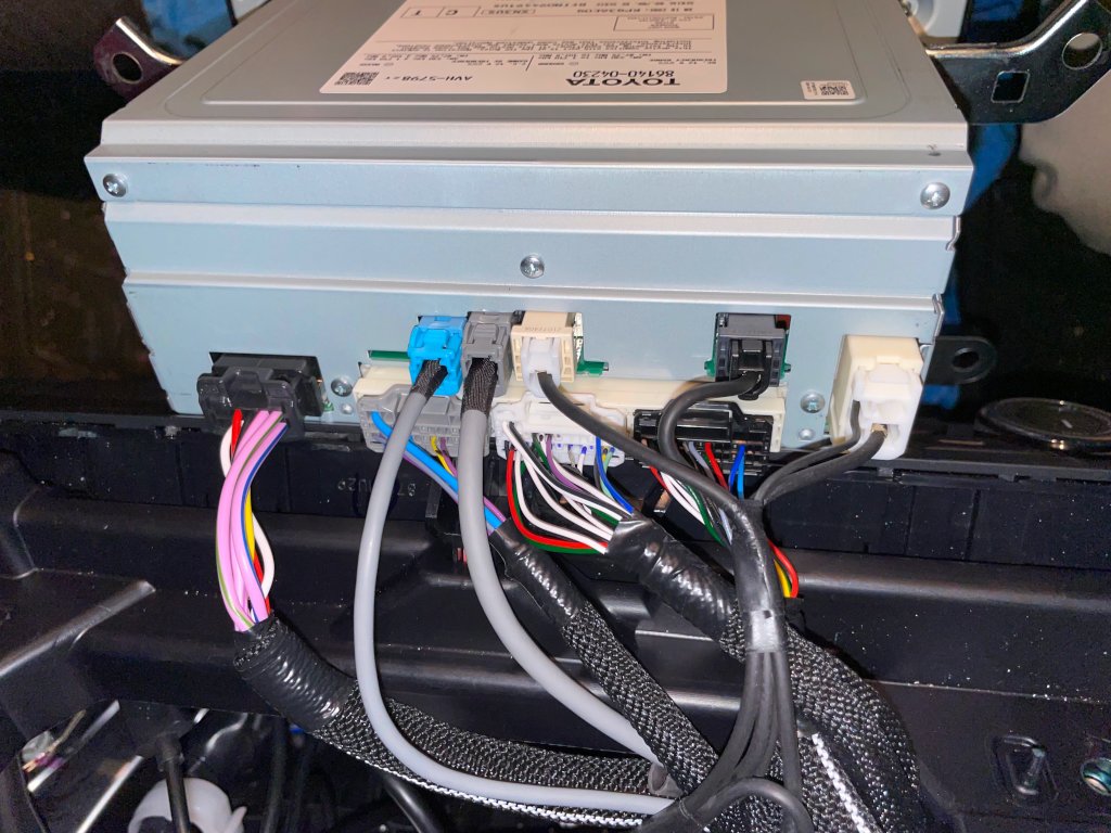

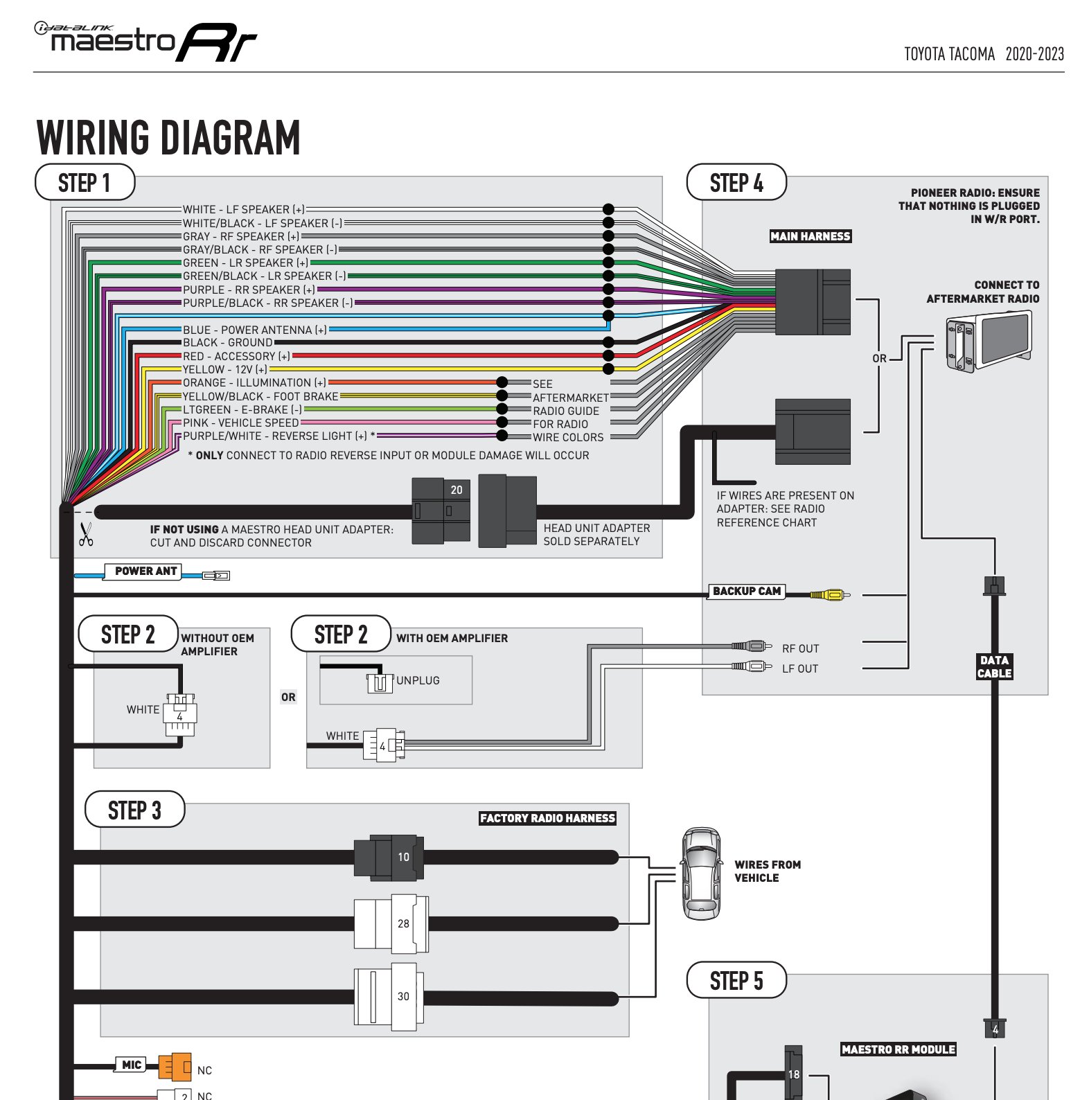

    So a few things this morning. First my biggest issue:
    I went to install my DMX1037S with the Maestro RR2. I am using the HRN-HRR-TO3 wiring harness. And when I pulled out my non JBL system - there are 4 wires connected, but the instructions only show 3 wires connected! Step 3 below. The crazier thing is that 2 Tacoma harnesses match the 28 pin harness! So I was able to get power to the stereo, but some stuff didn't work right. iDatalink's support is no up on the weekend, so I wait for that support. But I wanted to contact here to see if anyone had any ideas?

    4th would be either the mic or the usb/aux port underneath the hvac. both of which that diagram indicates aren't used.

    So there are 9 total connections on the OEM unit. On the top row I think it goes:
    Blue - Mic?
    Gray/Gray - USB?
    White - Satelite/GPS
    Gray - Satelite/GPS
    Bottom Row (upsode down)
    The left - that's the antenna
    The cluster of 3 28+ pin connectors and the black connector are the ones that plug into the harnesses. But that leaves me 1 extra connector.

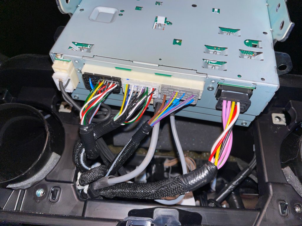

    Just went and tried this again. On that big cluster:
    White - 30 pin
    Black - 28 pin
    Gray - 28 pin
    Only the white and gray are used the black is left hanging.
    Because I’m missing the GPS and Satellite radio cables I’m not yet ready to put this all in, but I’m close.
    Also - had a camera issue, but that was solved when I changed the camera input (back to NTSC, the old camera was HD). So we appear to be cooking with gas.

    i guess i'm not understanding the concern. having extra plugs isn't really a 'problem', it's just stuff that either can't or isn't being integrated into the new radio installation.
    as with any change between equipment, there's always going to be something that doesn't jive, the important part is that the functions you require still work, or the new equipment offers a solution(for instance, a compatible mic for call functionality) to maintain the functionality you require.
