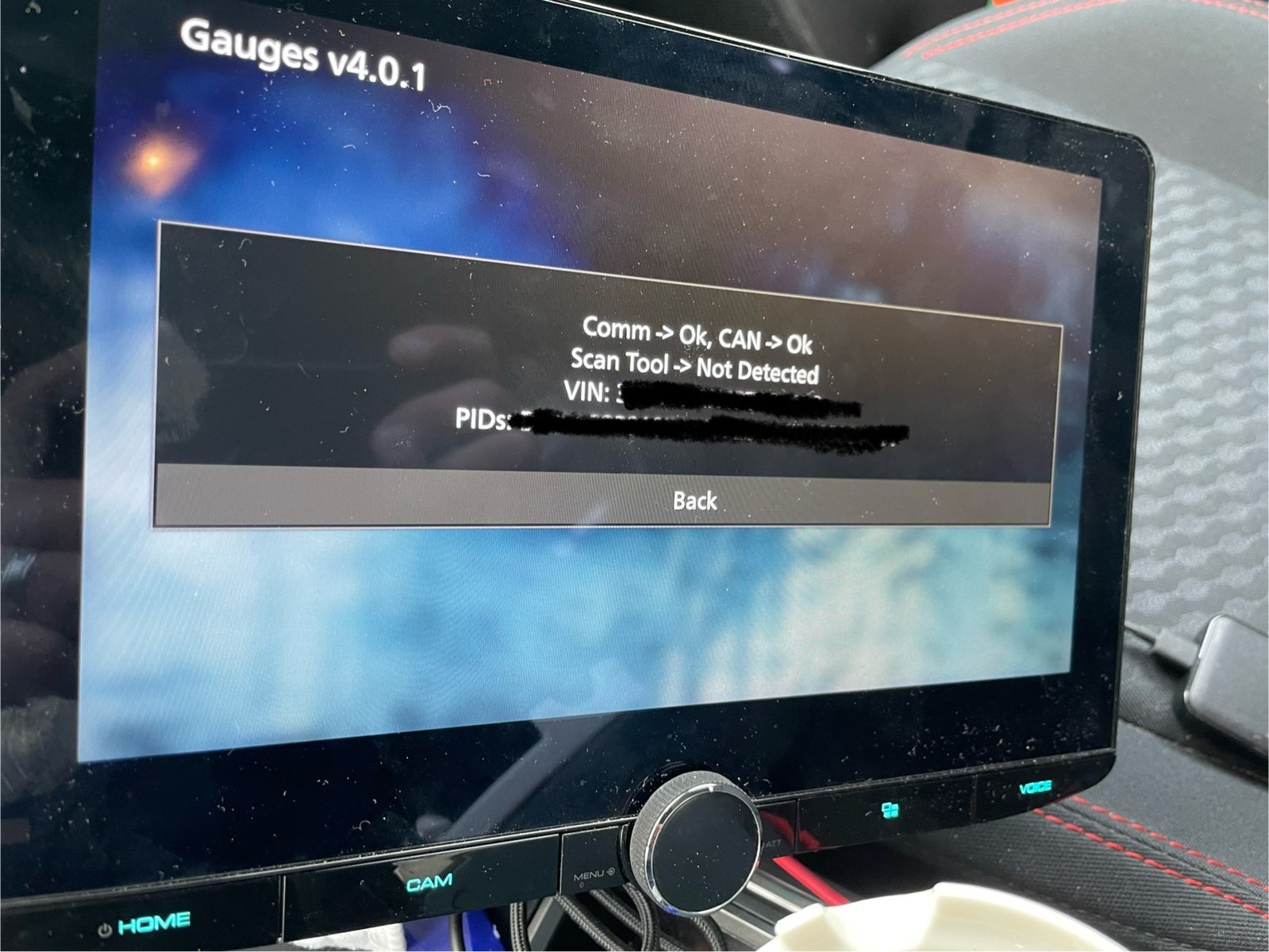

    I’m curious where this is coming from? Is your OBD function working without the dongle added to the truck? It would sure be nice if it worked that way, but on mine as soon as I disconnect the dongle I lose OBD. So I’m pretty sure you need it or need to do some custom wiring by finding the right pin on the radio harness to match a wire to.

    The OEM HU had to have some CAN bus interface, it was able to get TPMS and fuel data. I don’t have the OBD plug hooked up and it can get all of the data from the car, gauges etc work. I do get this message when I first start up gauges, but like I said they work.

    Yeah, I know the OBD goes to the stock head unit which is how the radio interacts with vehicle settings. I suppose I could look for the specific CAN wire on the radio plug that coincides with the one the dongle corresponds to on the OBD plug and then repin my HRN harness to make it plug and play. I just haven’t spent any effort on it.

    Sure enough, I unplugged the OBD connector and everything still works perfectly. I don’t even get that message you get. Looks like my evening project will be removing the splitter and that wire!
