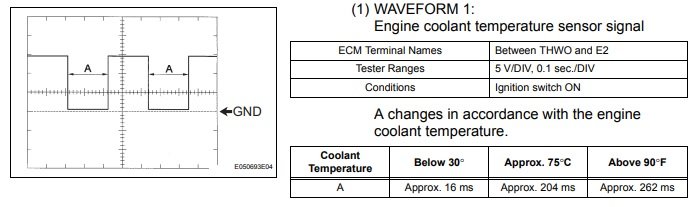

    Couple obstacles to overcome with non - toyota engine is the cluster uses a CANBUS signal from ecm for coolant temp.
    As well the AC amplifier wants to see an engine RPM signal and Compressor speed Signal.
    tacotruck 2.7[OP] and Dm93 like this.

    The temp signal isn't a CANBUS signal on 05-11 models but it is a PWM signal which changes frequency depending on engine temp, same signal is sent to the Combination Meter for temperature gauge control.
    2012-15 models did send the Temp signal over the CANBUS to the Combination Meter and sent a PWM Temp signal to the A/C Amplifier.

    Ahhh yes, that is correct.

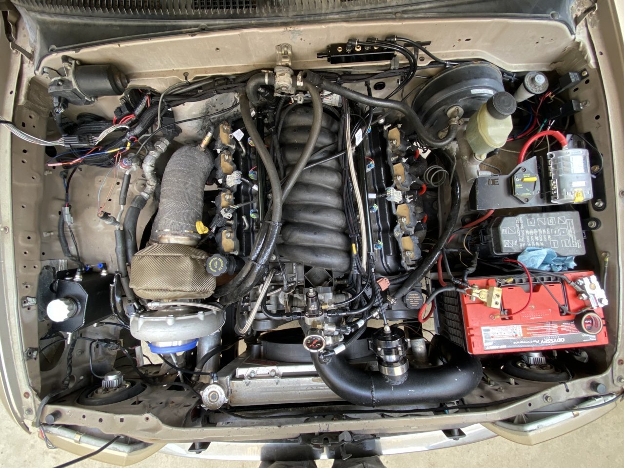

    @Speed Freek has put a turbo LS in his first gen. We are following his progress on the San Diego thread.
