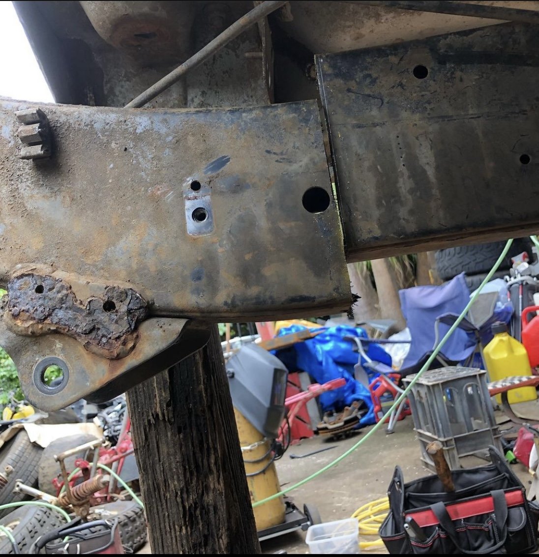

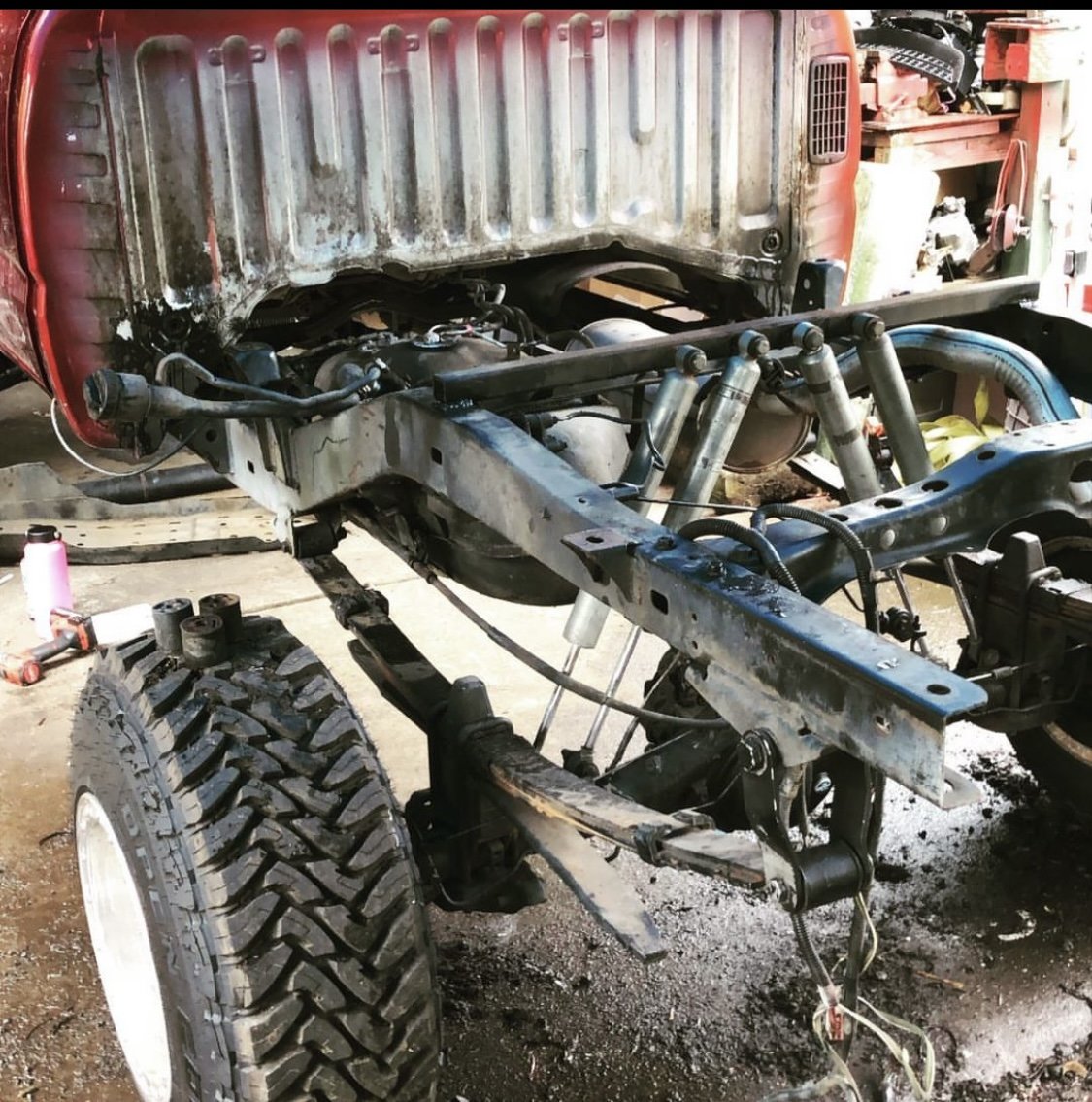

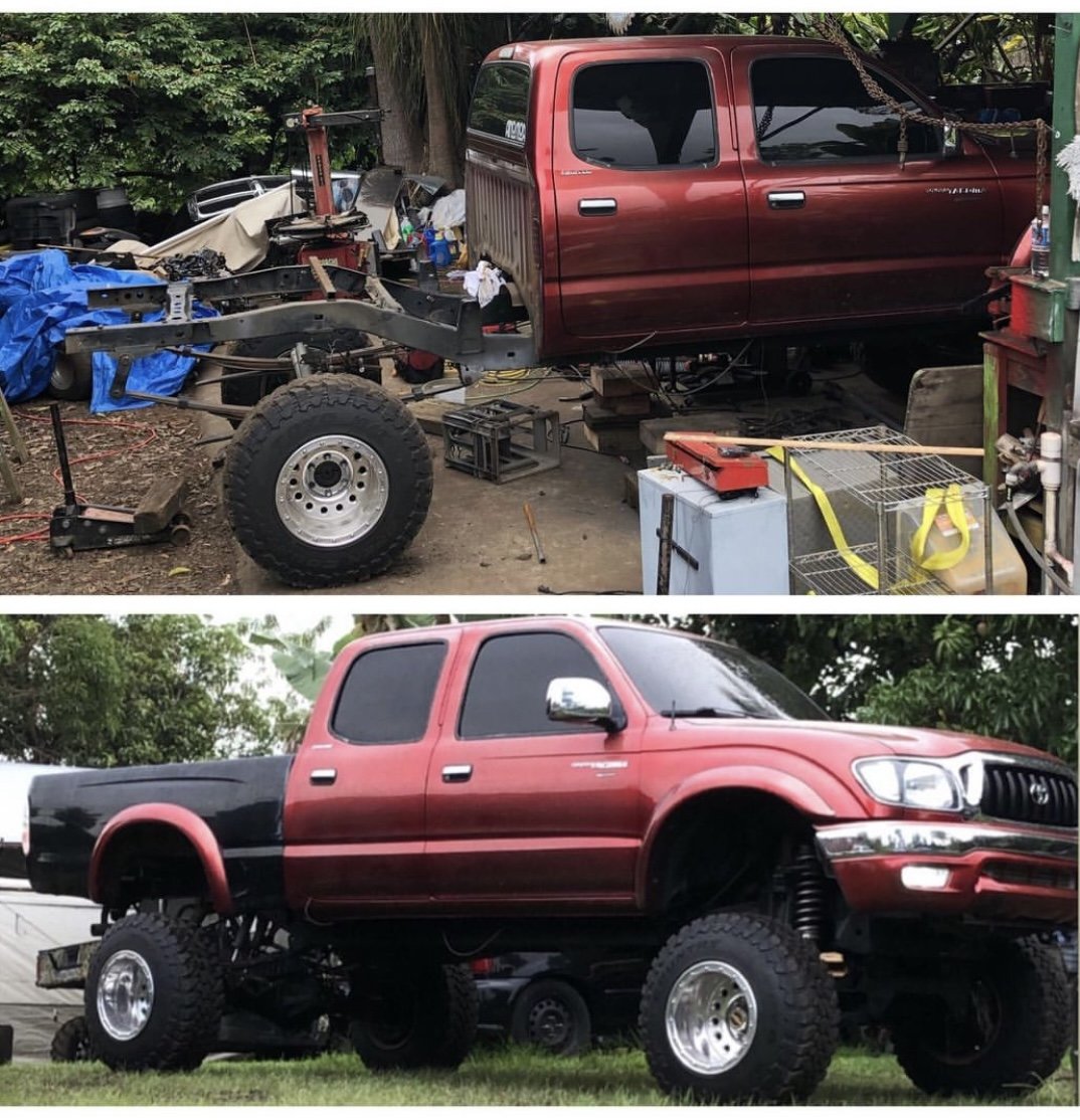

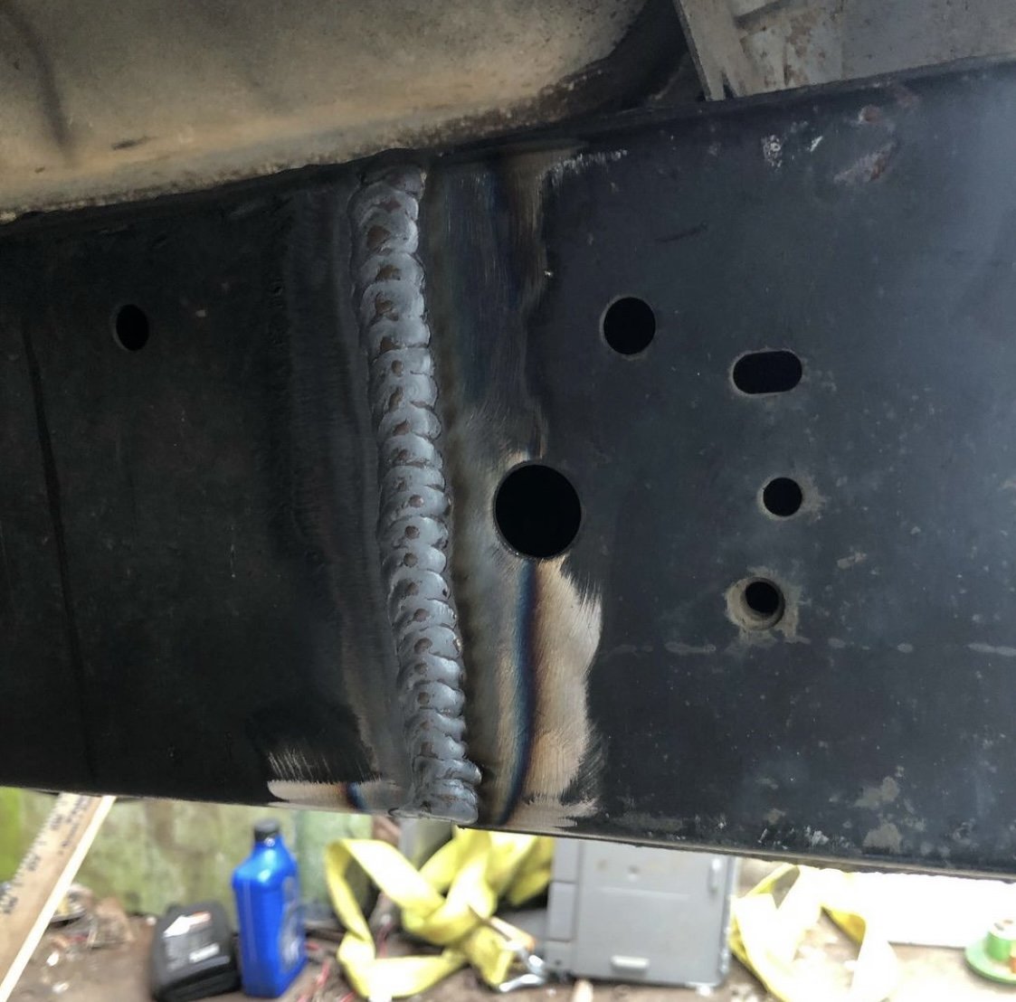

    I hate to revive an old thread but If anyone is interested I have a close friend that did this and took pictures of the process. It involved cutting the frame under the cab and extending the frame with some donor xtracab frame. The truck that he did it to was a monster… Twin-charged 3.4 with manual. Impossible to drive over 1/4 throttle.BC0BCB55-CB74-4877-9D6A-E6529B2749C1.jpg693013DB-C706-4C51-854A-5242651B4FE9.jpg 3D6FF3E4-4C15-4F32-8094-790277EE82A3.jpg18C8CA9D-E105-46BE-923E-F84E4BD5E8AE.jpg
