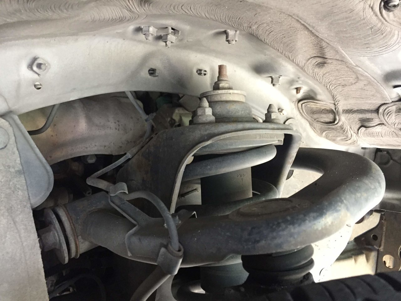

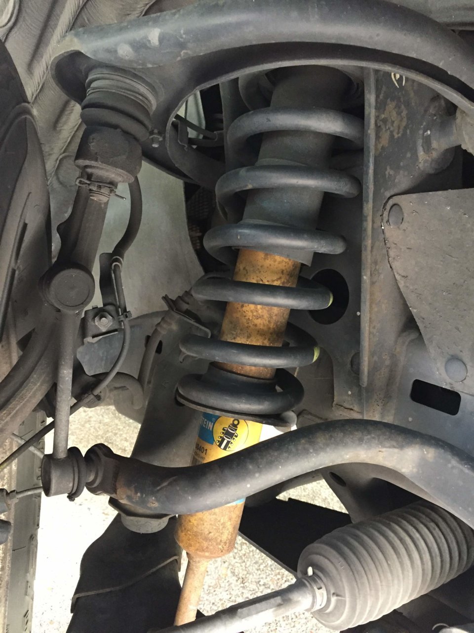

    I just picked up a 06 Reg cab prerunner MT. Previous owner had little to no information to share about the truck since his son drove it most of the time. So I'm in the process of getting a baseline with this truck by changing out the fluids and doing basic maintenance.
    I've never owned a truck or Tacoma before. Never had or driven a lifted truck.
    My questions are. Is my truck lifted? If it is, how can I tell what it is lifted on?

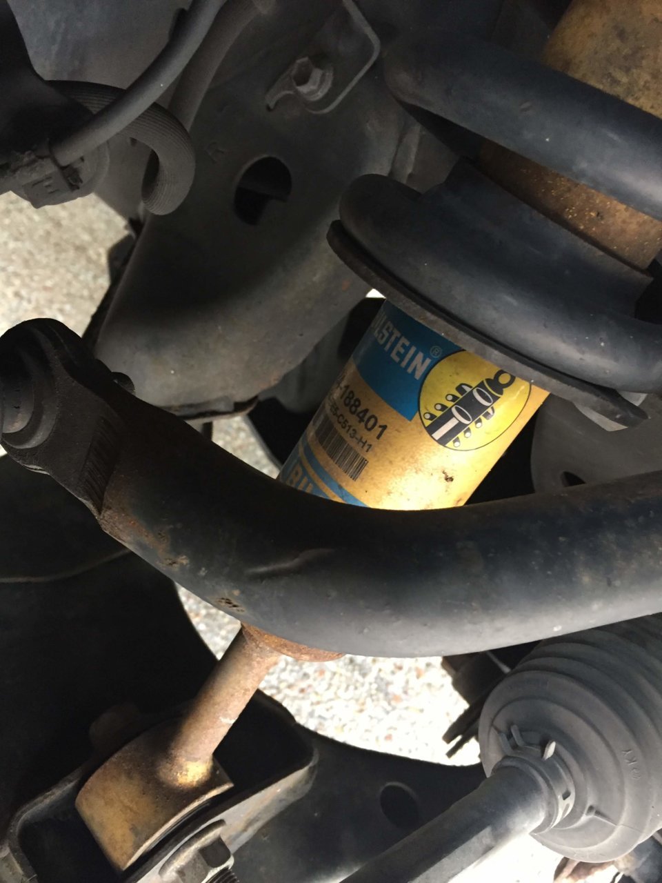

    I know they are on Bilstein shocks, but can't make out model number.
    Thanks

    Welcome, send a pic of the suspension. What part of texas are you in?

    Can you take a pic of the shocks? It does look like it is sitting higher than most single cabs. And the wheels are TRD Sport wheels, not the standard single cab 4 banger wheels, so my guess is yes.

    These are from the front. . .

    Looks like it's all stock

    Pretty sure the yellow shocks only came on the TRD sport and offroad models. You may be getting a bit more lift since those are meant for non-single cab configurations. The factory shocks on that model would be solid black.

    Those look to be the Bilstein 24-188401 - B6 - 4600 Shock Absorbers in the front, I like how the truck sits it does look good that way.

    Those are good shocks but they dont lift the truck, unless the bottom of the front coils are resting higher than on the stock shocks (like with 5100’s), thr coils are longer, or there’s a spacer on top (this truck doesn’t have), and if the rear springs are different and provide more space or arch over the axle than stock.
