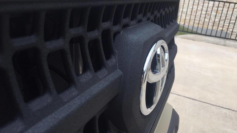

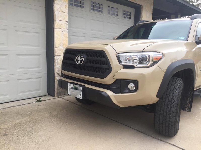

    I was thinking along the same lines as OP. I'm too rough on Plastidip. I've seen it wipe off of a grill while drying with a towel.
    I chose to go with Duplicolor Bedliner Spray. It looks OEM and my grill was done for under $10. It took 1 3M scuff pad and 1 can of Duplicolor. Scuff it down, hit it with degreaser, spray light coats of bedliner spray from about 12 inches away wait 5 minutes between coats. Keep applying spray 'til can is empty.
  4. Mar 31, 2017 at 7:16 AM
    #24
    goose443
    goose443 Well-Known Member
    Jun 8, 2016
    #189076
    741
    Austin
    Texas
    2016 Tacoma TRD Off Road 4x4
    That looks great! What kind of degreaser did you use?? And where did you get the supplies?
    Is this the bedliner?
    http://m.autozone.com/paint-and-bod...-16-5-oz-bed-armor-truck-bed-liner/291641_0_0
  5. Mar 31, 2017 at 7:23 AM
    #25
    Clearwater Bill
    Clearwater Bill Never answer an anonymous letter
    Oct 11, 2014
    #140097
    24,745
    Billy
    Largo Florida
    '13 5 lug AC w/convenience package
    A few OE parts from fancy trucks
    No. And since you don't seem to believe all the 'no's', go ahead and take it to the shop you have 'access' to.
    Don't trust a bunch of tools like us on the interwebz.
    :gossip: pssst, they will tell you no too. Bet on it.
    Order your color matched grill online, install it, sell your OE grill. Not everyone hates chrome.
    scottalot and goose443 like this.
  6. Mar 31, 2017 at 8:39 AM
    #26
    hookembevo
    hookembevo Well-Known Member
    Feb 11, 2016
    #177856
    1,564
    Austin, TX
    2016 Tacoma DCSB with 6MT
    Snugtop Rebel with some options Body Armor Rock Steps Rhino Mats Weathertech Mudflaps Radar detector hardwired to rear view mirror. Stereo upgrade: Amp: Arc Audio XDI805 LOC: AudioConnect LC7i Front Speakers: Hybrid Audio Technologies Claris 6.5 Rear Speakers: Hybrid Audio Technologies Mirus 5.25 Sub: Pioneer TS-SW2502S4 Box: Pioneer Ud-SW250T Bilstein 5100s OME 885 Springs Single Add-A-Leaf BFG KO2 265/75/16
    No. That's the wrong stuff. You want the blue can.
    I got everything at Advance Auto Parts. I always do the buy online/ store pickup route. You can usually find a 20% off coupon there.
    I started at the local paint/ body shop and they sent me to the local 4x4 shop. The owner took me out and showed me his 2015 Z-71 and he had used this stuff on his fender flares. It was 2.5 years old and looked awesome. That was all I needed to see. I'll probably wind up doing my flares with it too but I'm going to keep scratching them up for a while first.
    Here is literally every product I used for this job.
    Duplicolor Truck Bed Coating, Black, 16.5 oz. Aerosol
    Part No. TR250
    3M Performance Soft Sanding Sponge, 5-1/2" x 2-3/4"
    Part No. 03088
    Duplicolor Grease And Wax Remover
    Part No. CM543
    Since the spray is so cheap, you may want to pick up 2 cans so you can practice on a board or something. I have used it in the past, so I was pretty familiar with how to work with it.
    Here are my NotPro Tips:
    -For good adhesion, you'll want to scuff the entire surface. It takes a little time, but it's super easy with the sanding sponges I mentioned above. Just cut them to the sizes needed to get in between the grill holes. It probably took me 40 minutes or so to do a really thorough job of it. The surface scuffs easily and actually looks pretty cool with just scuffing (almost like stainless steel).
    -I found the best application technique is thin coats with the nozzle 6-8" from the surface and move the can pretty fast. To give you an idea, take about 1 second to make a complete pass across the grill.
    -Spray each coat from a different angle. You're basically trying to ensure coverage inside of each hole.
    -You'll probably want to do a couple of coats from the backside of the grill as well so that you get all the way into the back of the holes. It sounds weird but you'll see what I mean when you start spraying.
    -Don't worry about what it looks like as you start. As you keep applying thin coats, It will begin to have the texture of 60 grit sandpaper.
    -For best adhesion, only wait 5-10 minutes between coats. Allow time for probably 5-6 coats, which is all you'll get out of one can.
    -I called Duplicolor to ask about applying a clear over the top. They recommended not doing that. They said that the product already contains UV protection and does not require any clear.
    -I did a couple of little parts this stuff on my last truck (wiper blades/ door handles). It is a BITCH to clean up. Pressure washer will not take it off of your driveway so plan accordingly. I stuck a piece of plywood on top of 2 sawhorses and wound up doing the whole thing with no messes this time.
    I wanted the Pro grill, but I could not justify $400 for a piece of plastic. I decided to give this a go first and there's no chance in hell that I'm replacing it now. I've put about 2000 miles on the truck since doing this. There is no wear at all and it cleans easily with soap/water, bug remover, bristle brush or whatever.
