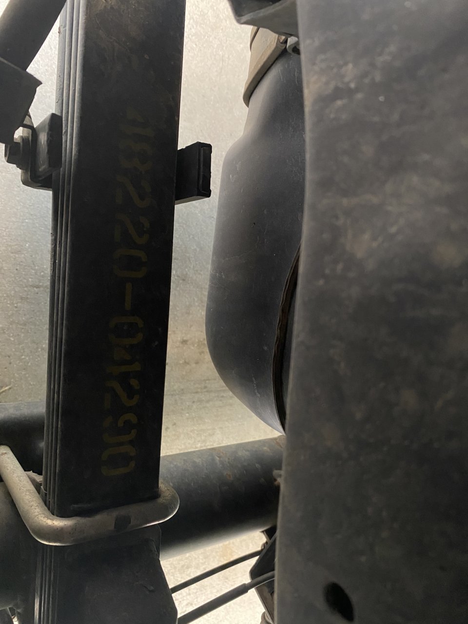

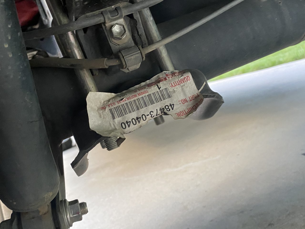

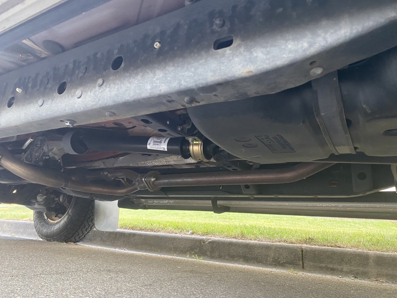

    I went to look at a truck for sale and noticed a few things. New stickers on the u-bolt plates, driveshaft looks new, and the leaf springs have a part number stenciled onto them. Is this indicative of the clunk TSB being performed?

    Doing some research it appears the part number on the driveshaft is the original part 37100-04350.

    Truck probably had the leaf spring cracking recall or driveline vibe tsb. Either way its still only a 3+1 stock leaf pack and even though its far better than the 2+1 leaf pack, its still a stock leafpack that will flatten quickly and doesnt handle loads well.
