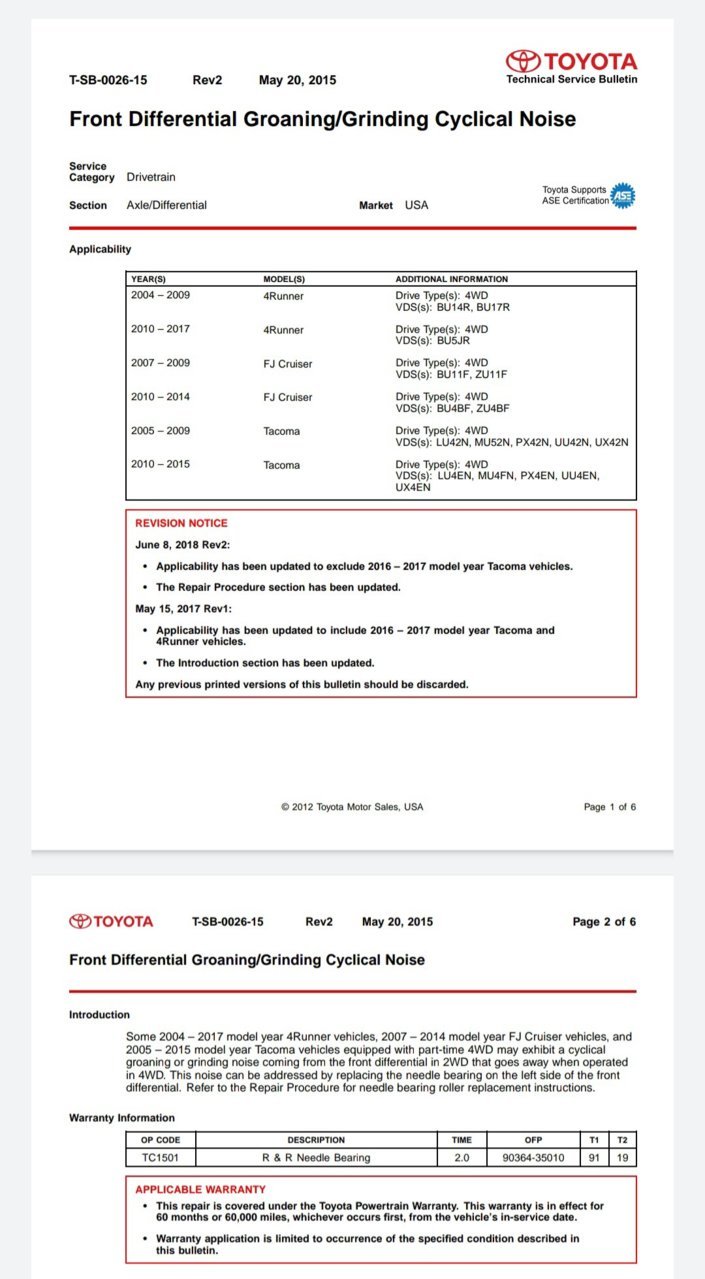

    Not true. Some completely stock 2nd and 3rd gen tacomas, Some 5th gen 4runners and even FJ Cruisers have the issue. Toyota issued a TSB for it. There is an issue, they just don't want to change the design for whatever reason.

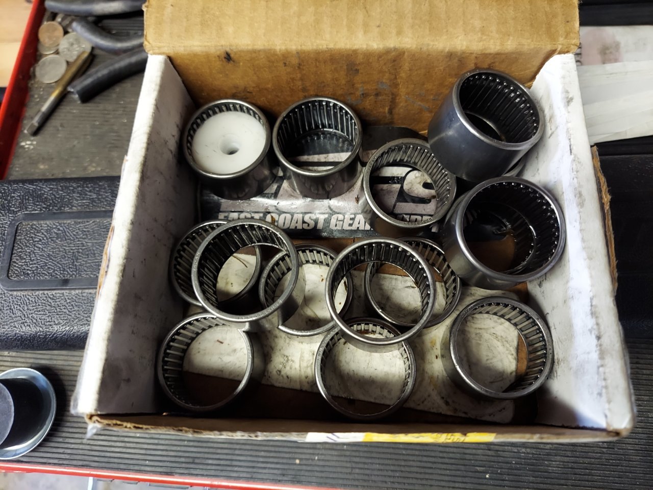

    Agreed as to being a little blown out of proportion. But when you get the vibrations/noise it's very annoying and concerning. Hence why I have replaced about 20 of them for various TW members.
