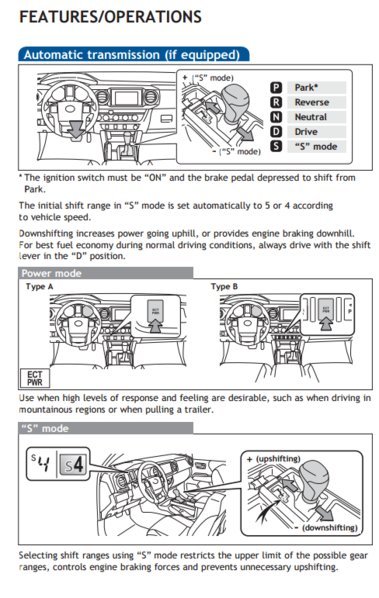

    When it's in S mode the highest gear it will go is what's indicated, S4 means it will not shift to 5 or 6. With the lever in D bump left and it usually defaults to S4 depending on speed. Doesn't mean you're in 4th, just that you can't go higher than 4th. Bump shift forward the limit is increased to S5 (1st OD gear) but it doesn't shift you to 5th, the truck can now select 5th if it wants. Bump forward again and you're allowing 6th gear, not shifting to 6th. Bump right and you're back in D which is the same as S6, all gears available.
    Manual even says to use S mode to reduce unnecessary upshifting.downloadfile.jpg
    My 1st gen has an "OD off button", does the same thing, keeps me out of OD 5th gear. 3rd gen has 2 OD gears, 5th and 6th, S mode limits one or both if I want to.
    S mode is not manual shifting, it's a shift gear limiter, truck still can automatically select the lower gears unless you drop it to S1.

    Thanks very much, in spite of all the less than helpful replies, this and a few others are very good. One last thing, how does this practice which makes sens by the way, work with or interact with the use of the push-button electric power mode feature. If your using that which I understand some guys use all the time, is it needed to also select the gearing limits as you describe or what is the best way to take advantage of both

    ECT just moves the shiftpoints out longer, makes throttle feel a bit more responsive too. I use D as an ECO mode if I want to try an save gas or don't care how the truck is driving. Most time it's just fine but if I'm merging on a short onramp, pulling something or just hoon a bit, I use ECT. Can be used in conjunction with s-mode too
