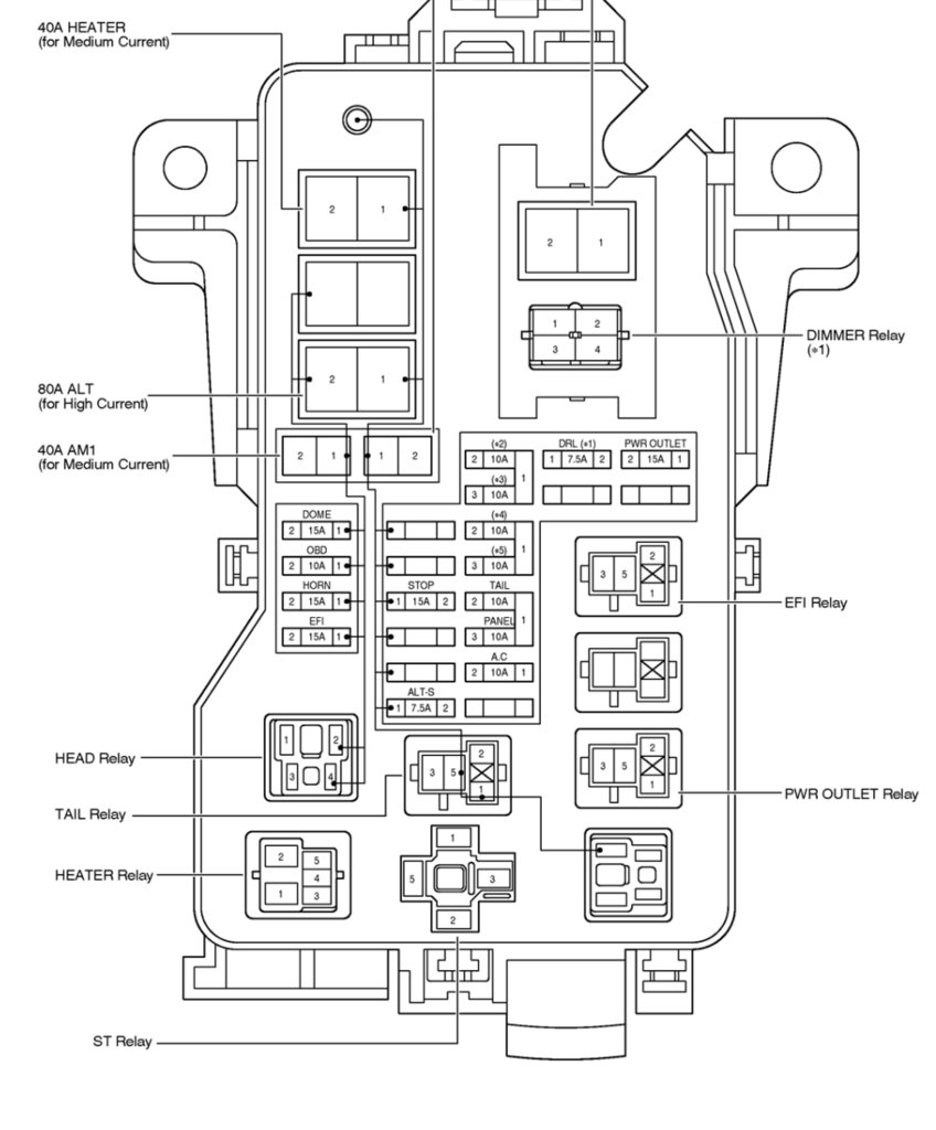

    This shouldn't be hard to diag.
    Let's go...
    Power = 12v
    Check the 7.5A STA fuse for power WHILE CRANKING.
    If good, Pull STA Relay. Check the #1 pin of the STA Relay while CRANKING.
    If Good check the # 5 pin for power.
    If good Check the # 2 pin for ground.
    If good, Go to starter. Check the Black/White wire while cranking (small wire)
    If good Check the big Black wire for 12v.
    Come back a tell use what is missing.
    If nothing is missing, we need to move on to a couple other test.

    FWIW, If you jumped pins #3 & 5. You should have sent power straight to the starter.
    You also said, nothing happened when you did that......
    That leaves power checks at the starter.....
    But still, Do ALL the test I posted above.
    Let's do this right.

    Did that have to be done w key held in the start position?
    HondaGM likes this.
  17. Aug 28, 2025 at 5:32 PM
    #17
    TnShooter
    TnShooter The TacomaWorld Stray
    Sep 2, 2010
    #42625
    21,612
    Deogee
    07' TRD Off-Road, Auto
    STOCK
    Not if you jumped 5 & 3
    5 should always be 12v. Key on or off.
    Diagram attached.
    HondaGM and pats73[QUOTED][OP] like this.
