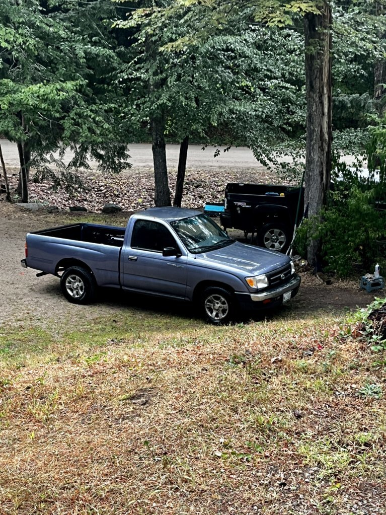

    Yeah, well Orange anus is a vile MF Demonic ra*ist Qupid Stunt who belongs under the prison aside from that… I Paid $1200 it’s got 155k clean Florida truck until 2019 surprisingly rust free! Got it started today thank God! (and this forum of course)

    Haha, yeah, again, agree with the sentiment, but anything pollytikal around these parts tends to give someone an immediate vacation. Didn't want you to get booted for 3 or 30 days while you were needing some help.
    You got a good deal, and glad you got it started! TnShooter is the man. I've got an old '77 Celica that sits for long periods, but I can always get it running when I need to. Air, fuel, spark, proper timing, and it will run.
