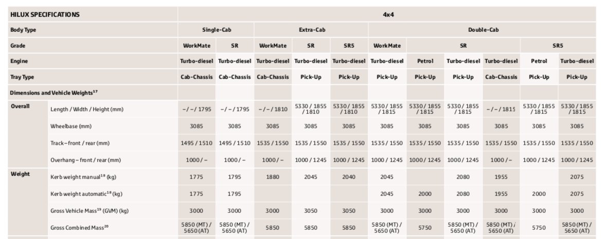

    Indeed, you gotta do what you gotta do. In the end trucks are just tools and you had a job that needed to be done. I'm just tilting at windmills that Toyota seems to build the Tacoma just good enough while the old Pickup and I think the Hilux still can be overloaded like that. It's rated in some configurations to be over a metric 1/2 ton truck, e.g. 1,225 kg of payload or 2,700 lbs. So even with a burly dude and a few tools you'd still have a whole lot of cargo left over. There wouldn't have been a widening gap I bet in that case. The Hilux GVWR is 6,600 lbs, which is +1,000 lbs more than the Tacoma (my door sill shows GVWR of 5,350 lbs) and it shows in how they're built.
