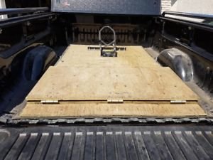

    Other than that any plywood wheel chock, assembly and tie down Input? I am
    Thinking about something like the attached photo (although my wheel chock will sit diagnolly in the corner of the bed)

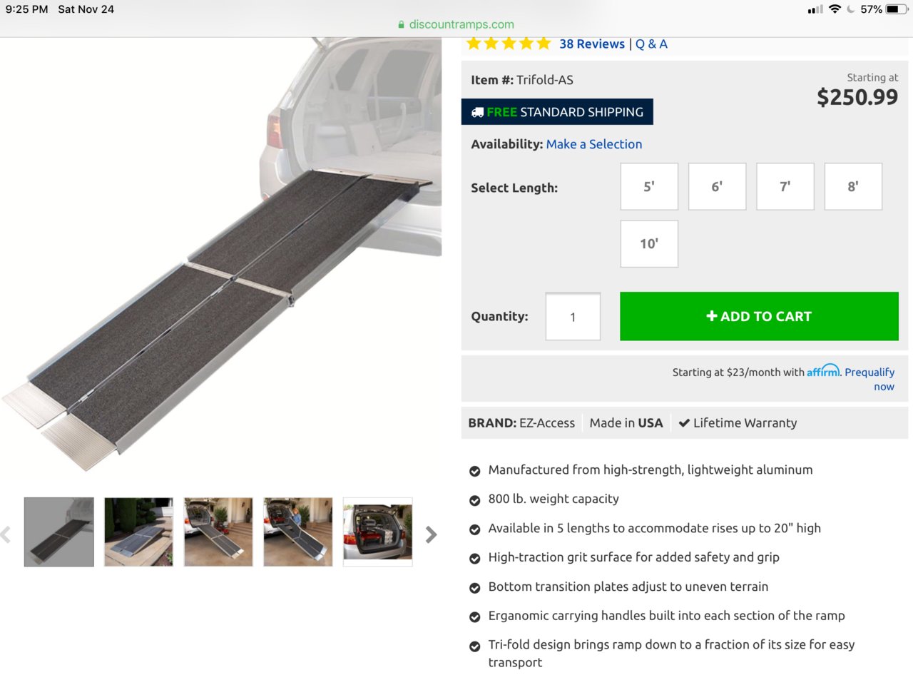

    You can always find wheel chair ramps used on Craigslist for 50.00-100.00 that will
    support 800 pounds too and they fold up nicely

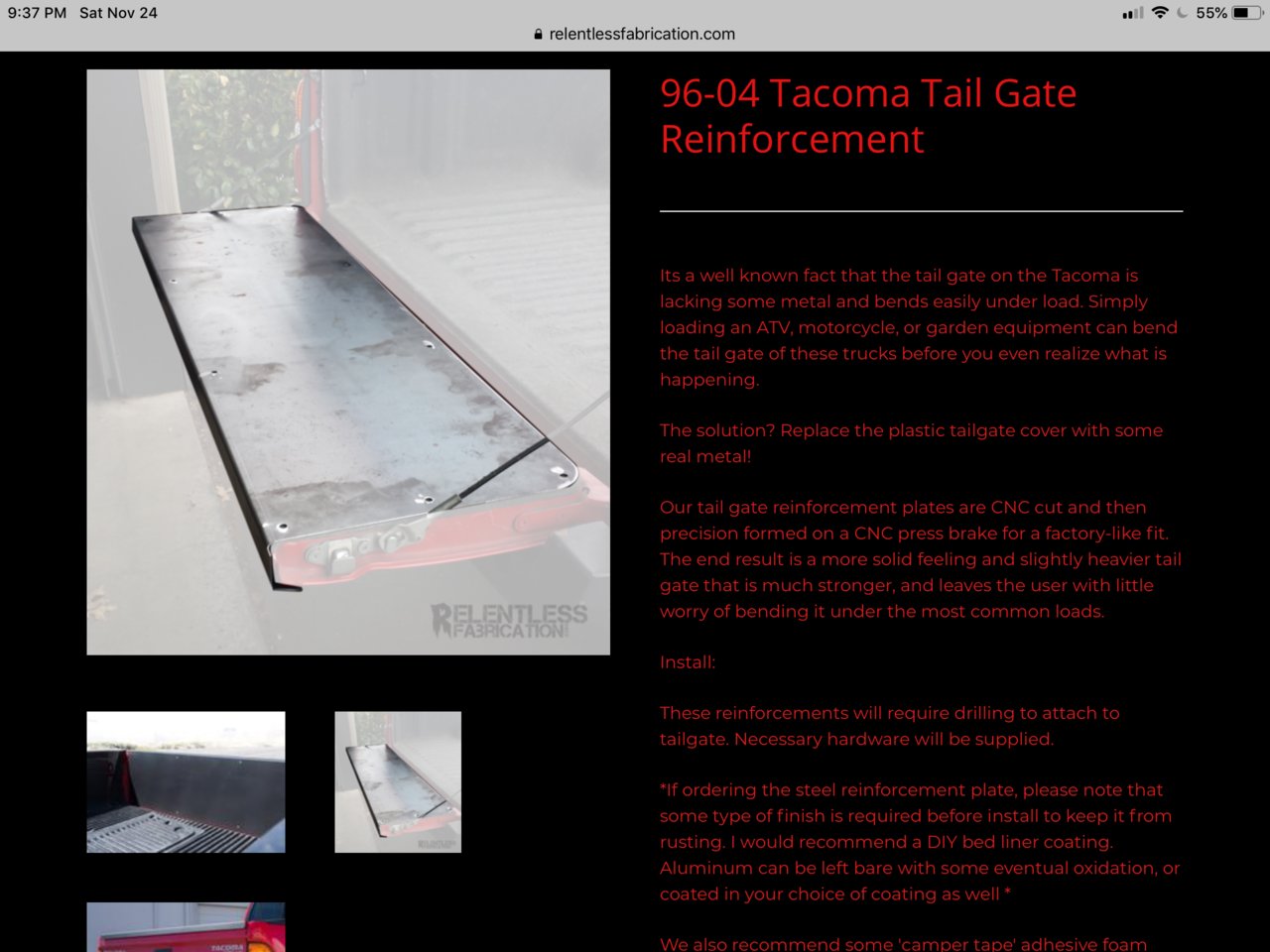

    Does anyone know the measurements of those tailgate reinforcements? I'd love to support them and buy one, but they don't ship to Canada, so I was thinking of getting my local metal shop to bend me one.

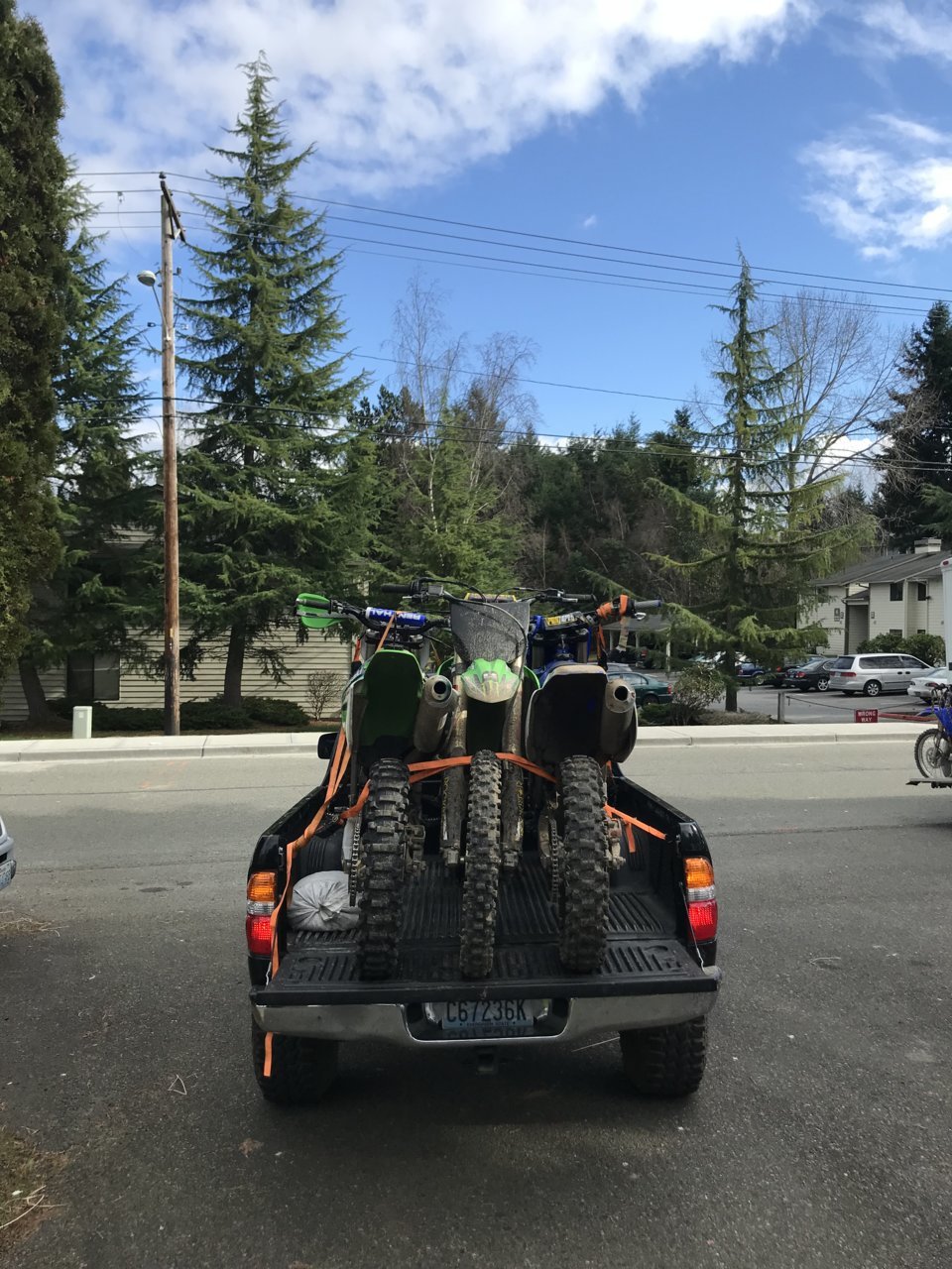

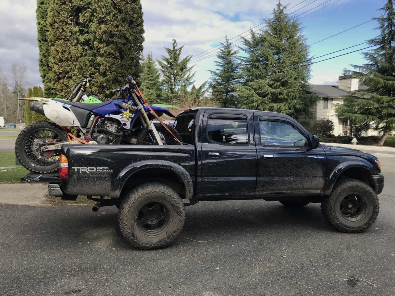

    I fit 3 dirt bikes in my 5’ bed. here is a picture for reference.
    2 bikes are 250cc 4 strokes and 1 300cc, they are about 240 pounds each. That’s +-720 pounds of just the bikes. Plus I had other gear we loaded after. Made a 2 hour trip no problem.
