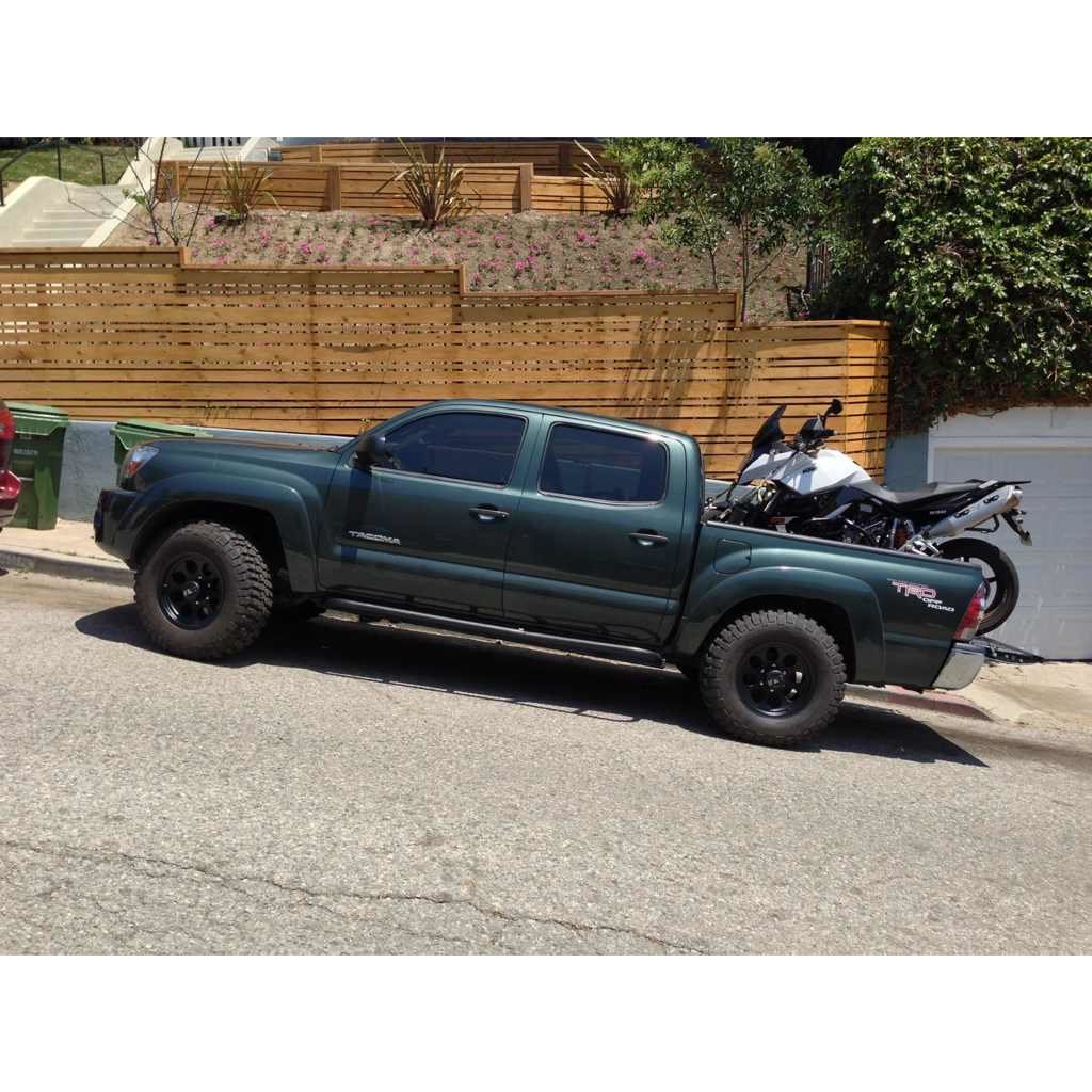

    Yea. My R1 fit in my DC as well. Strait in the rear tire was just past the tailgate crack. Rode really well. I think wet weight was 425?
  10. Jun 9, 2013 at 9:04 AM
    ohpyramids
    ohpyramids Well-Known Member
    Sep 26, 2012
    #87766
    79
    ak
    Los Angeles
    2010 DCSB TRD 4x4
    My 460lb KTM made it in ok. You may want to look into a tailgate reinforcement plate though.

    x2, see if the bike will fit diagonally. You probably wouldn't be able to tow a camper with the tail gate down.
