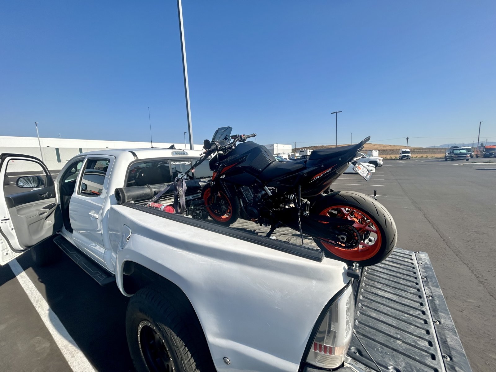

    Here’s my 400lb Duke in my truck.
    It was no issue, Get some canyon dancers if you have a full fairing sport bike, then two extra tiedown for either the rear Passenger pegs or Somewhere else on the rear of the frame if you want to be safe.
    I only drove an hour or so but across country you could do this for extra security.
    6’ bed is no problem,
    my experience is tying down moto bikes for 20 years and then helping customer tie down street bikes at my dealer job for a few years now. I’ve never seen an issue long term.
