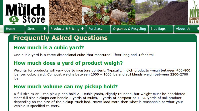

    Too add to your estimate and another poster's experience, yes a 6' bed will hold (about) a yard (depending on material, heavy solid yes, light and fluffy, not quite)
    It usually weighs more than you'd think. Dry topsoil is nearly a ton per yard. I'd think compost would be less but not by a lot.

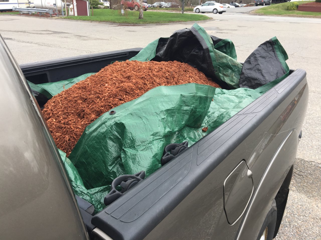

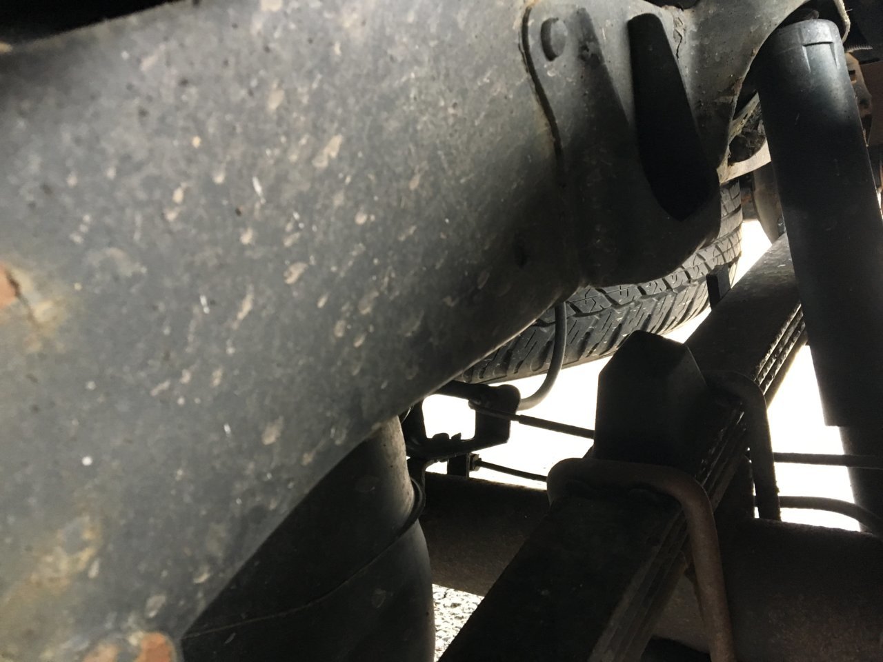

    I picked up a yard of mulch this weekend and took some pictures...
    Yard in the bed
    Bump stops not even close...and the mulch was damp/heavy from rain that A.M.
    I have a stock 2010 access cab with the TSB 4 Leaf pack...
