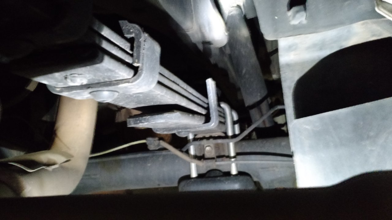

    How many leafs are on the leaf springs? 2+1 overload or 3+1 overload? If 2+1 they're the old style, and you can get get a new set for free from the dealer.
    If you already have the 3+1, you can look into sumo springs or firestone airbags. Both are great for the occasional heavy load. New leaf packs aren't the best option for that.

    This is the right one, so I'm guessing that's a 3+1. Dang! I was hoping for a free dealer upgrade. :)

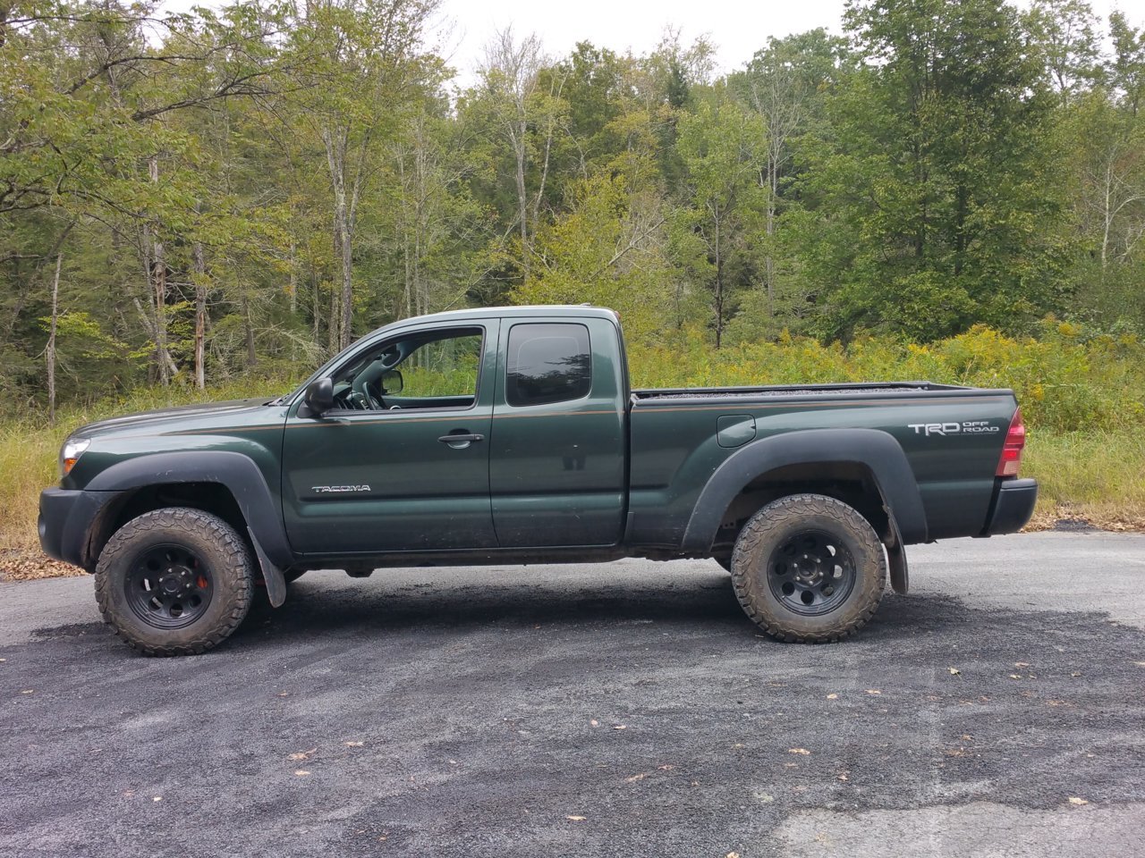

    I heat with rice coal and haul it myself, I make 2 or 3 trips per year. This is a picture of one of this years load, it's 2100 pounds, you can see the coal very near the top of the bed. The truck sits level because I installed Air Lift Ride Control air bags Kit #59561 in the rear (@50 psi). I don't advise loading that much weight,it's not legal, but can be done. I only have to drive about 25 miles loaded. 20180924_163701.jpg

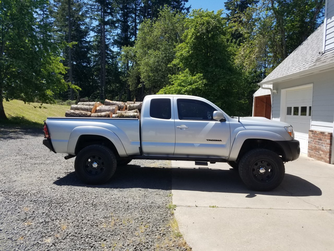

    This^^^ this picture the bags were only at 10psi

    1,593
    His rear spring picture showed clearly that he's got 6-clip version. No free springs for him.

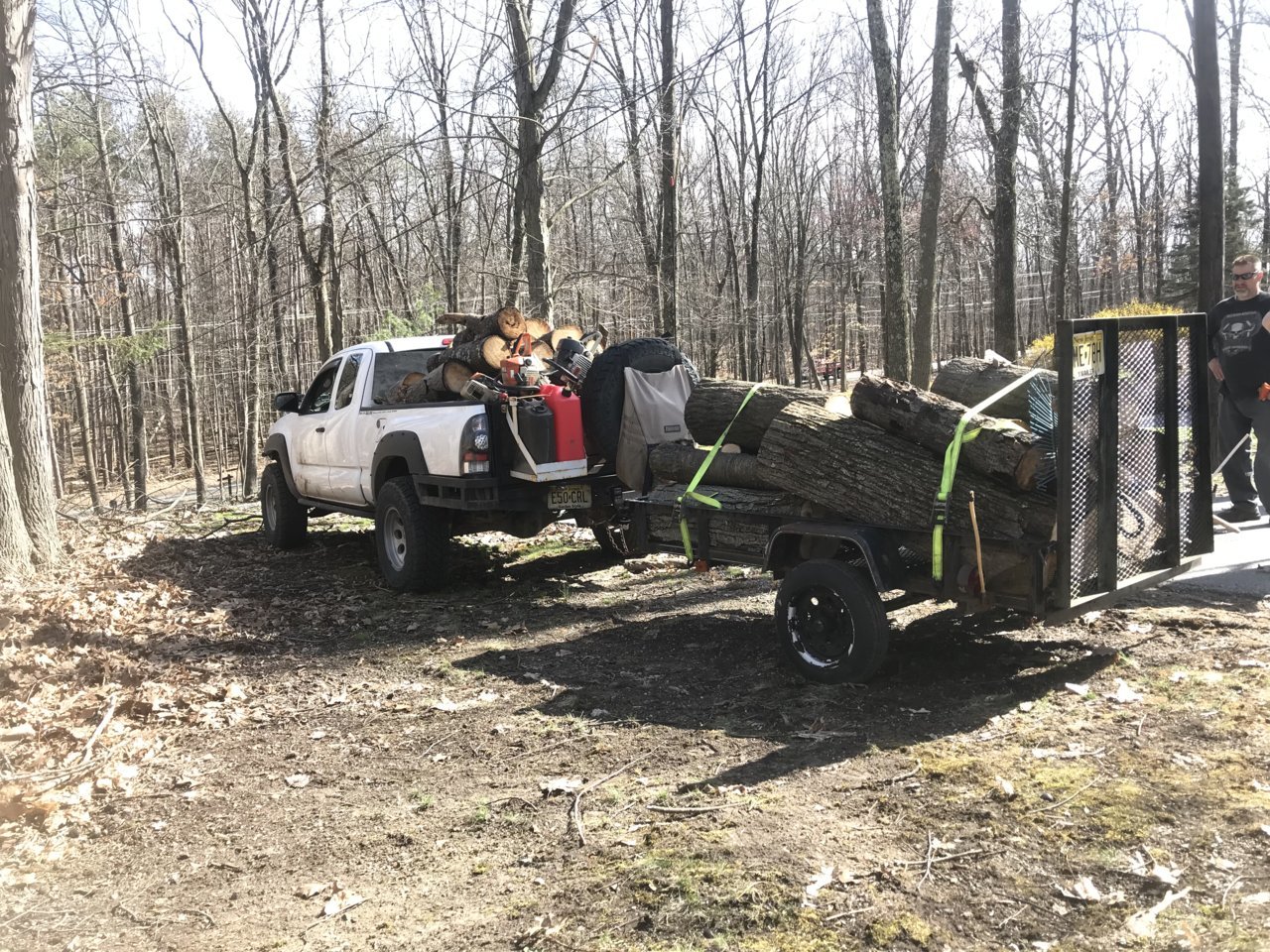

    No airbags here, I only do this once or twice a year.
    I do have 5100 billies all around and OME MD Dakar spring pack (EL095R) in the rear.
    This load of oak was about 1/2 inch above the Timbren bumpstops (ABSTRFK) which are taller than the stock stops slightly.

    I had the same issue with my first gen Tundra. I put a Wheeler's 3 leaf pack in. No issues since. It doesn't even squat.
