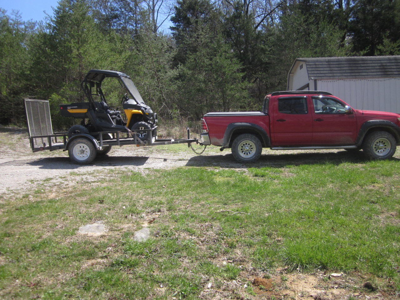

    Trailers are handy for hauling things that just won't fit in the bed of a Taco, as well. I haul my Cub Cadet Challenger 400 Side by Side on mine, as well as my 54" cut lawn tractor, my 44" walk behind, and SO much more!
