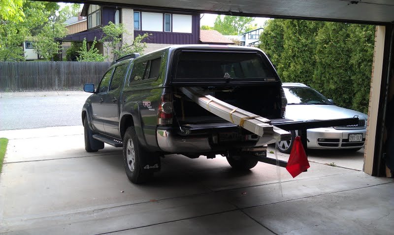

    i did it this way:
    16' MDF has no structure to it flops all over the place. Used tie downs in the bed and through the window. Extender is awesome.

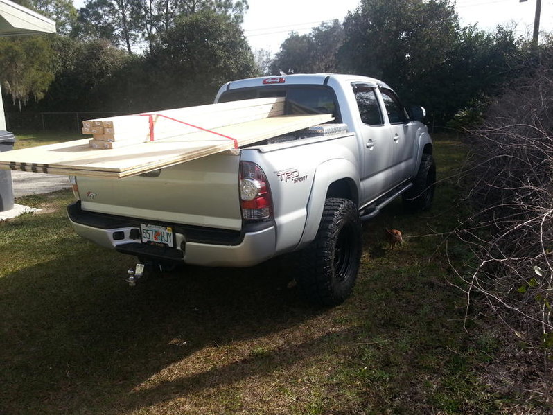

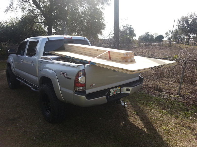

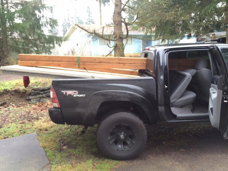

    Found this thread when I was looking for different options. Just wanted to share another idea. I used my 3/4" plywood to support the 12' foot boards and didn't have any issues. 16 footers would have been just fine also using this method. Rather than a bed extender just buy a sheet of plywood and return after you're done if need be.

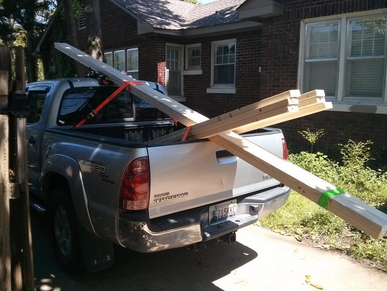

    Here's what I did to carry a few 16 ft and 8 ft boards. An old blanket to pad the roof, a couple straps wrapped once around the bundles at each tie spot, and some duct tape at the end to hold the 16 footers together. This worked with no problems whatsoever.

    Gotcha. I figured it was some kind of forum lingo that was over my head. But yeah, I thought briefly about going through the window, but that didn't give me a good feeling. Over the top was super easy. The only potential problems are if its hanging too far back (tail swing), or gets too tall (clearance issues). My route was easy enough given the setup I used.
