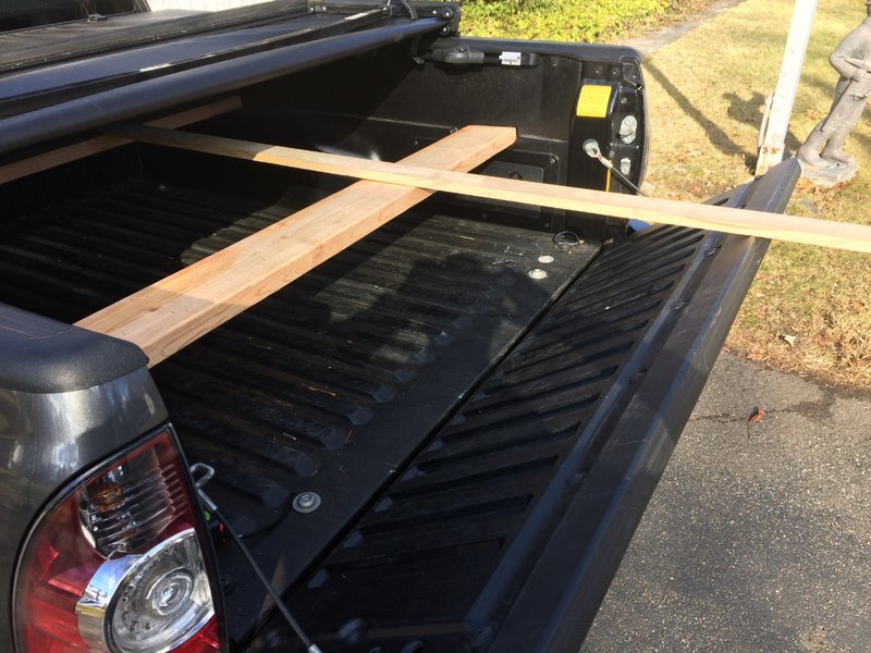

    Change of plans. Did this mod instead. Plenty strong enough for the few sheets I tend to carry.

  9. Dec 3, 2016 at 9:59 AM
    #89
    LocknLoad
    LocknLoad Well-Known Member
    Aug 28, 2014
    #137109
    203
    near the Cherohala Skyway, TN
    2015 DC Off-Road 4x4

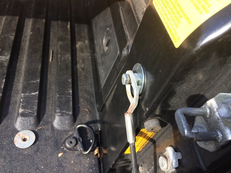

    VSSMAN -
    Great idea
    Did you buy those shortened cables or make them?

    There the stock cables. I drilled two holes in the bed for bolts. Pull out the tail lights to get at the back side of the holes and use fender washers to spread out the load. The other idea that would work is to go off of the track with epoxy coated chain and a snap clip. Have the length of chain be so that the clip goes onto the cable end supporting the tailgate at the correct height.
  11. Dec 3, 2016 at 10:10 AM
    #91
    vssman
    vssman Rocket Engineer
    Jun 17, 2013
    #106440
    10,377
    Paul
    Naugatuck, CT
    2013 SR5 double cab
    BTW, the tip of the tailgate is 6 1/2 feet from the front of the bed. Still need to run a strap around the corner of the sheet from the swivels to hold it in...

    Joined this forum just so I could "like" Vssman's post. I've been looking for shorter tailgate cables for a while. Vissman's solution of adding additional attachment points never occurred to me -- great idea.
    I have the hitch extender but have been looking for a more convenient way of hauling sheet goods. I've always wanted to use the tailgate but couldn't figure out how. I've also used my bed extender with a 2x4 attached to the top but am concerned that it will collapse under the load and spill my sheet goods all over some intersection.

    Welcome to the forum. Took a bit of thinking until it dawned on me to add cable attachments. Plenty strong enough for several sheets of material.
