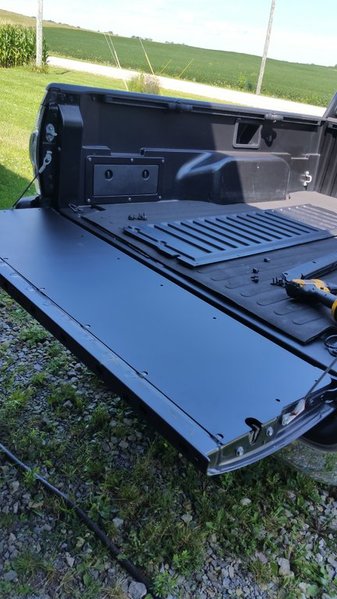

    I tried. Tailgate wouldn't close and I was fighting sunlight between installing that and the core/hurst short throw shifter at the same time after work. It's in the garage as a project for another day to see why it wouldn't fit without modifications.

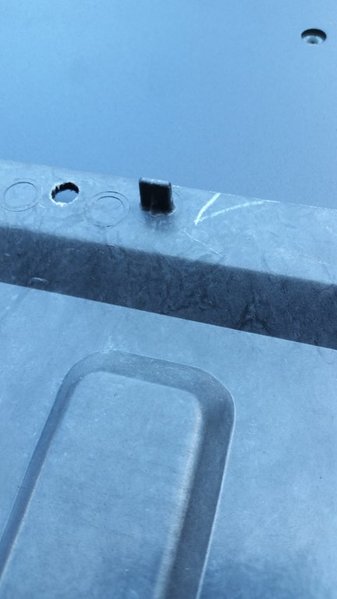

    Shipped out today will be here tomorrow! How come it wouldn't close? was it the 3 plastic tabs which need to be dremeled out?

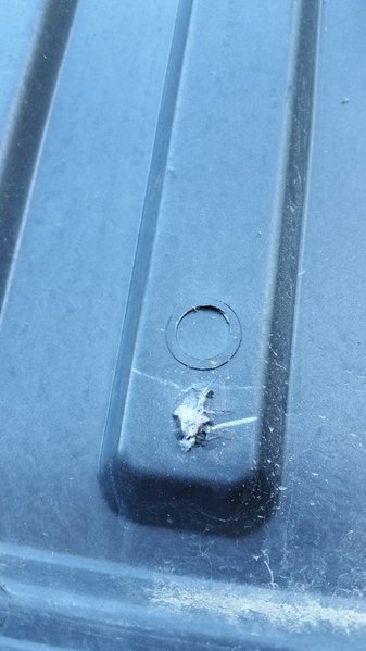

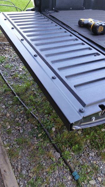

    Just snip those tabs of the plastic stock tailgate cover and the steel one will slide right under it.
