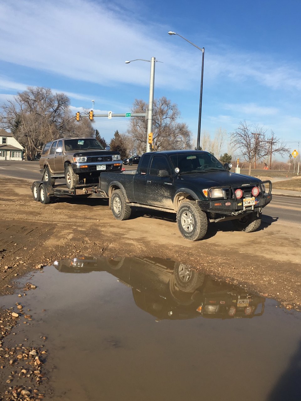

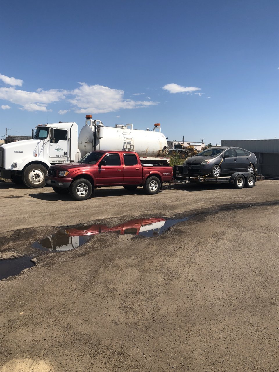

    I’m with everyone else, either supercharge or new truck. That being said my current Tacoma and my last Tacoma have been supercharged, and it helps towing immensely. FFA97BC4-5AD0-49DE-B891-70B18F5C573B.jpg
    This was the worst I ever did with my 2000 5 speed. No trailer brakes, and it was before I did my tundra brake upgrade. It was lifted on 33’s
    this is the heaviest I’ve done with my 04, tundra brakes and trans cooler were installed, but this was before I did trailer brakes. These trucks will tow with some decent power added, and a supercharger is the best way to add a lot of power in my opinion

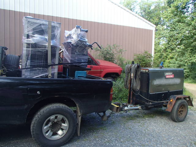

    Not sure why you think your truck is a Dog when loaded.
    Are you in the Mountain West pulling up those passes I would worry more about getting down.
    If you feel that way time for a full size Truck
    This is my normal day for my truck .
