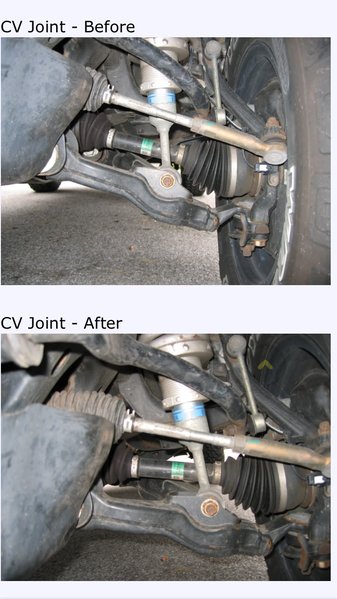

    With that upfront, you might as well just put blocks in the rear same low cost. Differential drop is unnecessary but the intent is to improve cv angle.

    Before and after CV angles:
