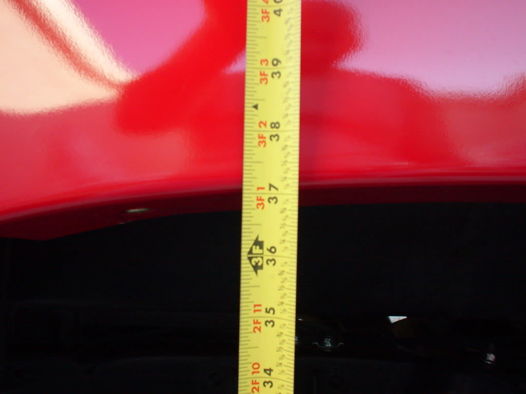

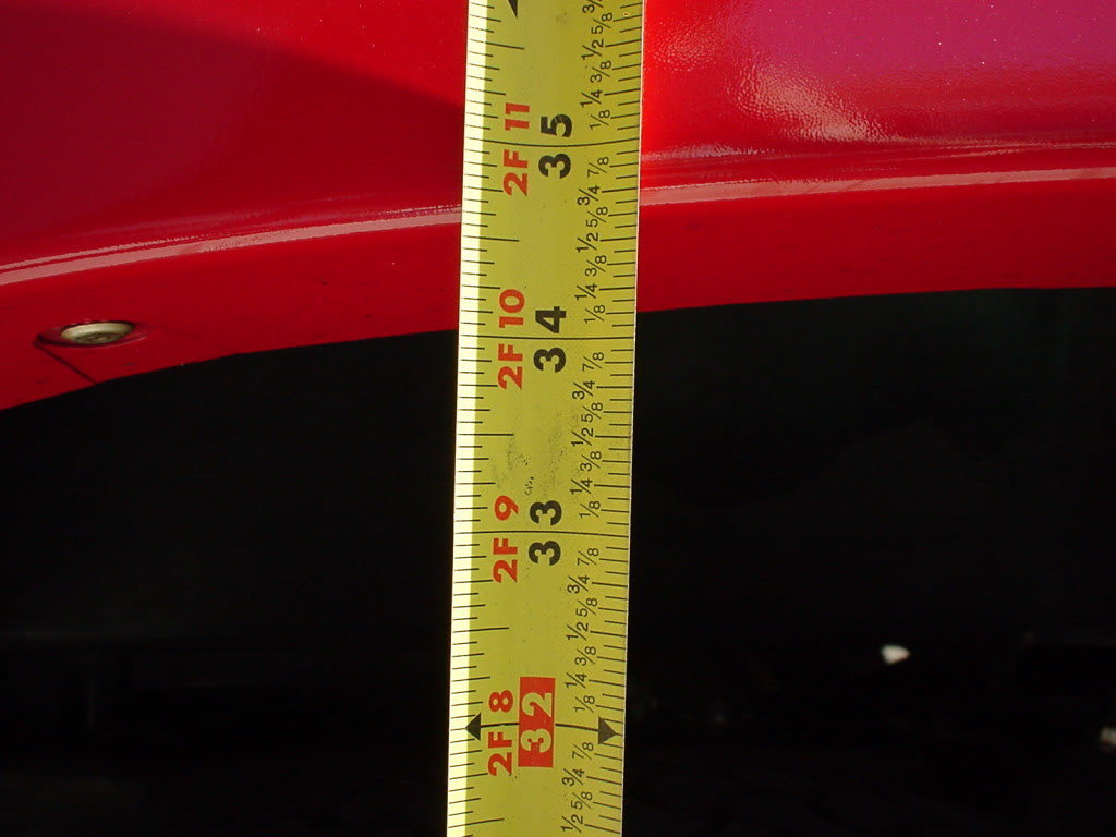

    The Dealer was great. I did the TSB because I have a snugtop on order and didn't want it to SAG, plus with weight in the bed. Also, I tow a MasterCraft at times.
    With the snugtop, and the TSB 4 leafes, it was only a 1/2" difference in height
    Without any weight, I gained 2 3/8" with the 4 Leaf TSB
    Here's the Pix:
    Before: (Sorry of pic angle it's at 34 5/8")
    :eek:
    After:
    MC: Total weight Loaded, Gas, Stuff 5200lbs.
