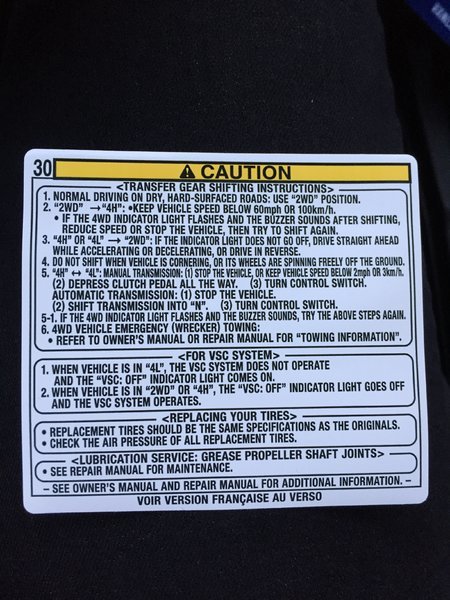

    Before I get :crapstorm: on, I have searched 4hi top speed here. I understand the manual says, at least for my turdgen that I shouldn't exceed 100kph (60mph) in 4hi. The problem is that before I checked the actual speed your allowed to travel, I've taken my "buddies" advice. We get a lot of rain here in Vancouver :canada: and when it's an insane downpour and I'm on the HWY I'm usually doing 110-120kph in 4hi. So my question is for anyone that has experience with this, does Toyota put a cap on the speed at 100kph so we don't excessively speed in 4hi or will it actually damage the 4wd system? Yes I know , if you need 4hi you probably don't need to be travelling faster then that but I'm just curious if I've done any damage. Thanks guys! IMG_2495.jpg

    You only need to be under 60mph to engage 4H. After that, drive faster if you wish.

    That reads the same as mine...you need to be below 60 to engage the 4hi....nothing about a top speed once you are engaged in 4hi

    Well... I think the statement, "2WD (to) 4WD Keep Vehicle Speed Below 60mph or 100kph" means what it says. You keep it below that speed. I don't think it has anything to do with the speed you engage the transfer case.
    Artimus: If I'm reading this correctly, I don't think you're going to damage your rig unless you do this frequently.
    Chime in, troops.

    It's under the section about shifting the tcase. As others said, under 60 to shift, drive as fast as you want after.

    Yeah, I see it there too... I'm one of the minority of folks (I think) on this forum that have actually read the 640 page manual. Here it is. I wonder what Toyota says about it.
    Shifting from “2WD” to “4H”
    1. 1 Reduce vehicle speed to less than 62 mph (100 km/h).

    Keep it below 60 to SHIFT into 4Hi, then you can go as fast as you want. If you try to shift into 4Hi above 60, it'll yell at you and not shift. Once you're in 4Hi, you can go faster and you'll be fine.

    I agree with others that have said go as fast as you want once in 4wd. I have also read the manual multiple times and it only has to be under 60 mph to engage 4hi. From other TW members recommendations and knowledge if you use 4hi for your monthly maintenance on dry pavement, only engage when your driving straight, turning on dry pavement while 4wd is engaged is when you can cause damage because you need your front wheels to be able to slip to keep strain off the transfer case and other components of the front 4wd components. In the rain as you have been doing you should be just fine.
