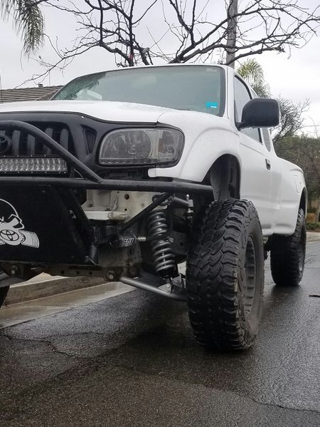

    Hey guys, I have a 2003 tacoma prerunner with long travel in the front and a full cage in the back, the ride is amazing and I love this truck but when I jump it or take an incline really fast my tires hit the top of my fender flares. I want to add about 2 inches more clearance and have thought about just doing a body lift but I want to see what ideas you guys have. Thanks in advance

    It's less Tacoma and more mod
    You probably don't need more lift, sounds like you need a propped hydo bump or air bump stop system to make bottoming out smoothed

    Trim your fenders, limit your bump travel, or add a bypass and tune it accordingly

    Trim fender. You probably don't need to do much.
    And you probably should be running bumps anyways.
    Also if you really wana spend the money you can get 3" lift spindles but that will raise your cg and youl wana raise the rear some too.
