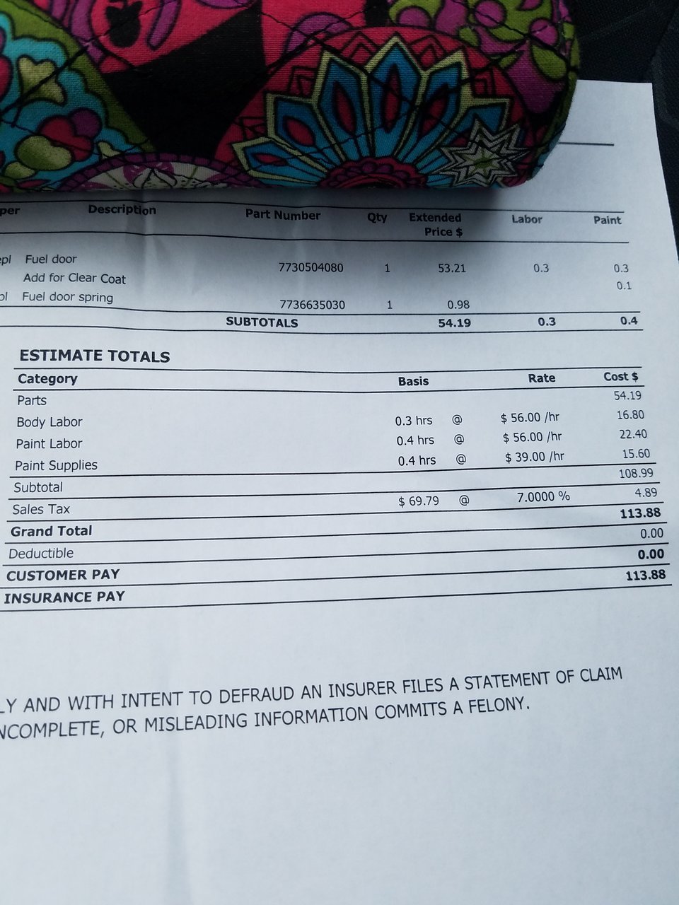

    So, went to the gas station and put gas in my truck just like I've done a hundred times before except this time when I went to shut the door it warped and collided with the side of my truck scratching it at the top. I didn't want to mess with it at the gas station so I had to drive home with my fuel door open like an idiot. Once I got home and had a chance to look it over I could not figure out for the life of me why my fuel door was Now crazy warped for no reason. It would not shut. I took toit toyota body shop and he told me that the hinge is very flimsy and that because I live on a gravel road, the hinge got full of dust and seized up. When I shut the door with the hinge not moving freely it bent it.
    Moral of the story, put some oil on your hinges.
    They area deciding if it is be under warranty or not .$103 if not.

    Pictures?

    Nice pillow.
    In Vancouver BC that would be about $1000 Canadian. Which is about $113.88 American

    Looks like a purse maybe?
    Either way, sucks about the unnecessary hassle with such a simple part. Hope it all gets fixed.
