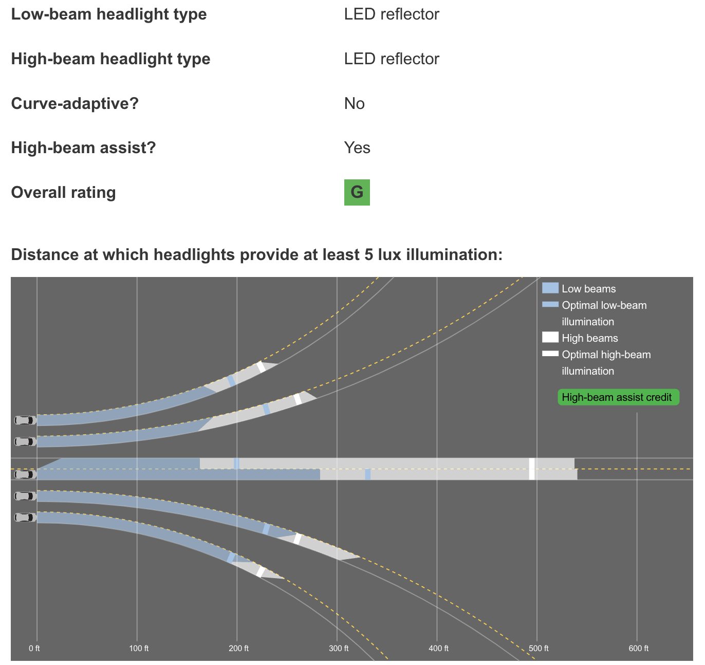

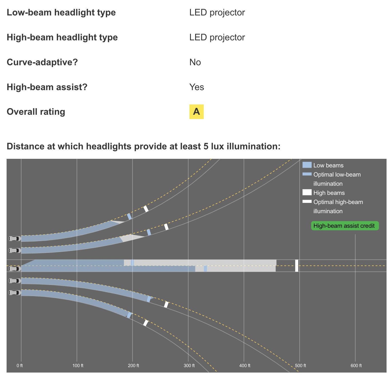

    IIHS does headlight testing and the 3g LED reflector headlights have just about the same low beam performance but better high beam performance. The 4g has projector based LED's. See below
    3rd gen

    4th gen

    Wow fantastic chart, I completely forgot they published these.
    This perfectly illustrates how the high beams do literally nothing in corners.
