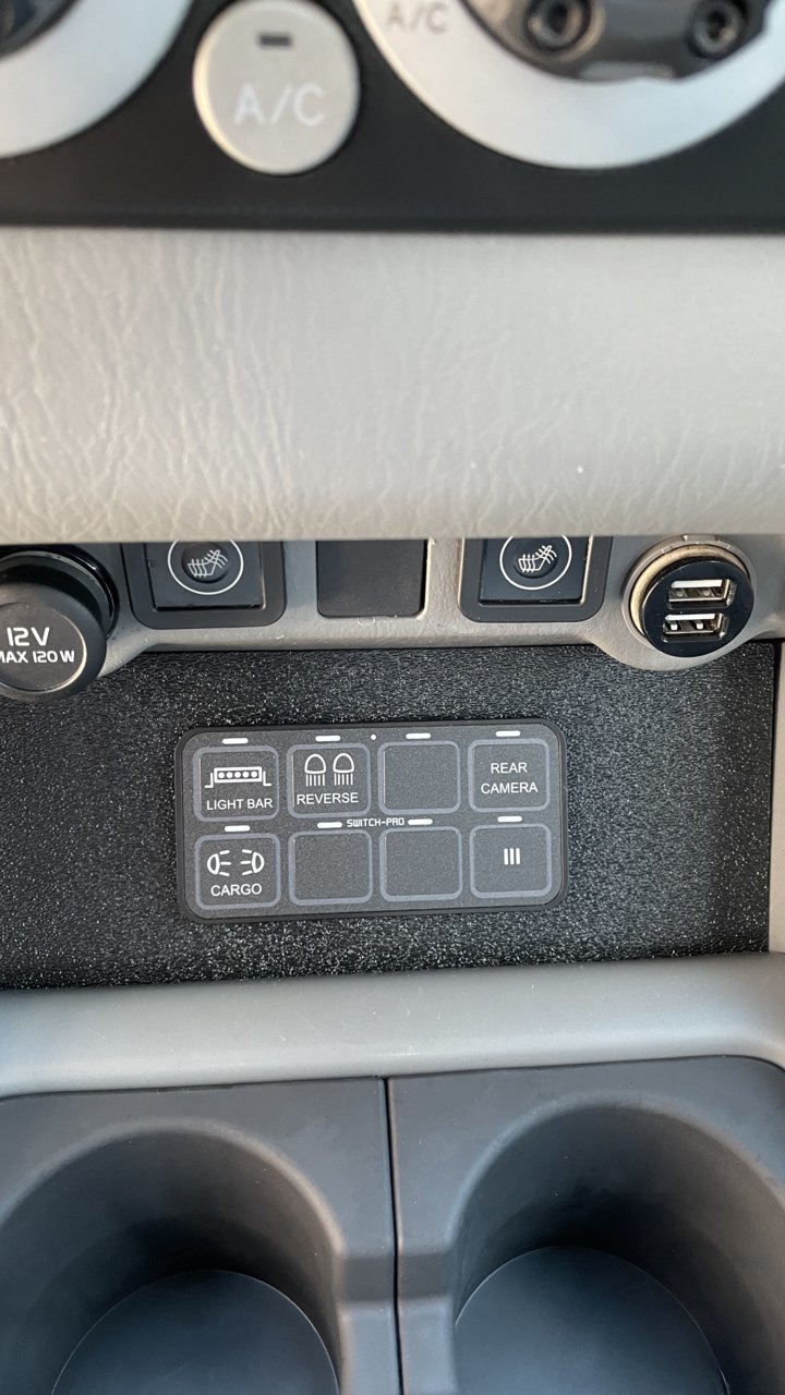

    I like your cubby cover pretty nice! I ended up making one my self for my Switch-Pro

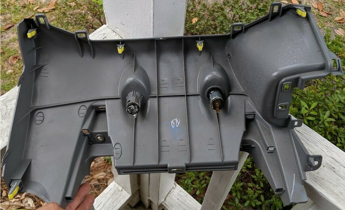

    The frame everything attaches to behind the,"dash," is the same till '12 I believe. It'll bolt right in. Gotta remove the console tho and it's maybe 10 bolts total. Console, dash, etc.

    There's nothing behind the panel, you could trim a hole and secure it without buying a different year panel.

    You could, but there's no other surface on that panel that will put the new switches on the same plane as the lighter and power outlet. That was why I bought a new lower dash trim.

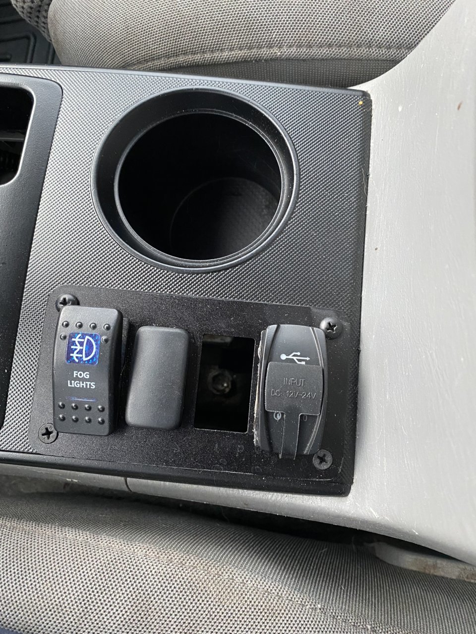

    I could cut a hole as he said, but I definitely like your idea. Where’d you get the newer panel?

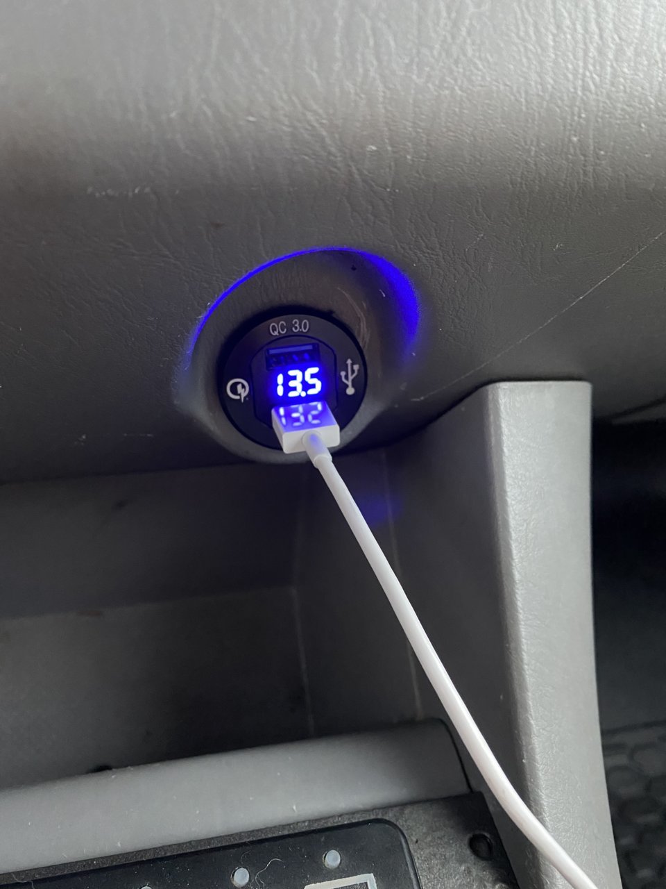

    I couldn’t get the cigarette lighter socket out without taking out the trim and other dash parts so I just ran it behind the little tray under the ignition for now.
