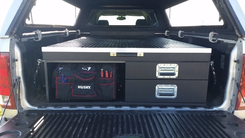

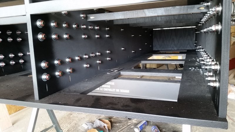

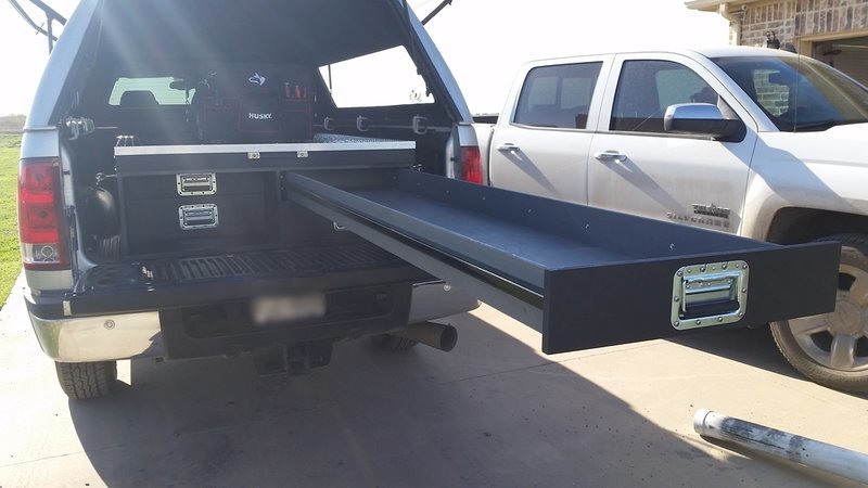

    Of all of the research I have done this is the build I have found most impressive, it appears to be running off of bearings that glide on metal tubing:

    One of the primary concerns I have is that I live at the beach and the air is very moist and tends to cause wood to warp or bow overtime. I was thinking to counter this that I would have to get a very dense wood that would withstand weathering a little more than your average sheet of ply.
    If you have any building ideas or experiences with your drawers/storage system please share, would love to hear others input before investing into building one of these.

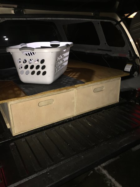

    I built mine out of 3/4" x 6" pine and 3/4" birch ply. sealed with thompson water sealer. (Dirt and water WILL find its way in there)
    Mine is also a bed platform, i lived in my truck for 7 months while in school in Leadville.
    My slides are wood on wood. routered a groove in the frame, smaller groove in the drawer and inserted a very hard wood in the drawers channel to act as the slider rail. used some wood slider wax and have a roadie storage box handle for my pull handle. No moving parts, so nothing to get stuck or break. It slides easy.
    tips i have, figure out what you will carry, estimated weight, pick the lightest material that will work, no point in adding unnecessary weight.
    If what you are storing is an odd shape or could stick up, make sure it wont catch and prevent the drawer from opening ( i have top loading access panels on mine for this reason/access stuff without opening tailgate

    Im curious, I noticed you had squares cut out on the bottom of the drawers, did you do that to shed weight? Ive seen that in a couple of build and I'm curious as to why that is done

    yeah, its just framed up that way, no reason to make it solid all the way down, saves a decent amount of weight, never had and issue with flexing or anything like that.

    Cutouts were to shed some weight and to make installation and removal a little easier (it gives you somewhere to put your legs when you are shuffling the carcass in and out).

    Our drawers use a similar bearing system to your first photo up top, and it doesn't limit you in sliding length, like regular slides would do. We have a drawer system to fit in these, but it's not full bed length though, it's 1.3m, 51.1" long.

    What did you use to fasten all of the bearings to the wood sidings?

    Just a boatload of 5/16" stainless button head bolts sandwiching the plywood and bearings.
    It goes from outside to inside: Button head, washer, plywood, washer, nut, bearing, nut
