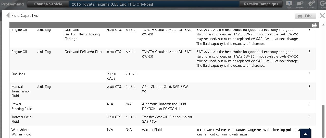

    I wouldn't say I neglect anything but this is synthetic and it's viscosity is engineered different then conventional fluids and since I don't offroad or tow the wear is less.
    I did my trans dump at 60K and now finally getting around to the diffs and transfer case at 103K
    Does anyone know the weight of the fluid and amount for the tacoma TRD 2016 Trans case?
