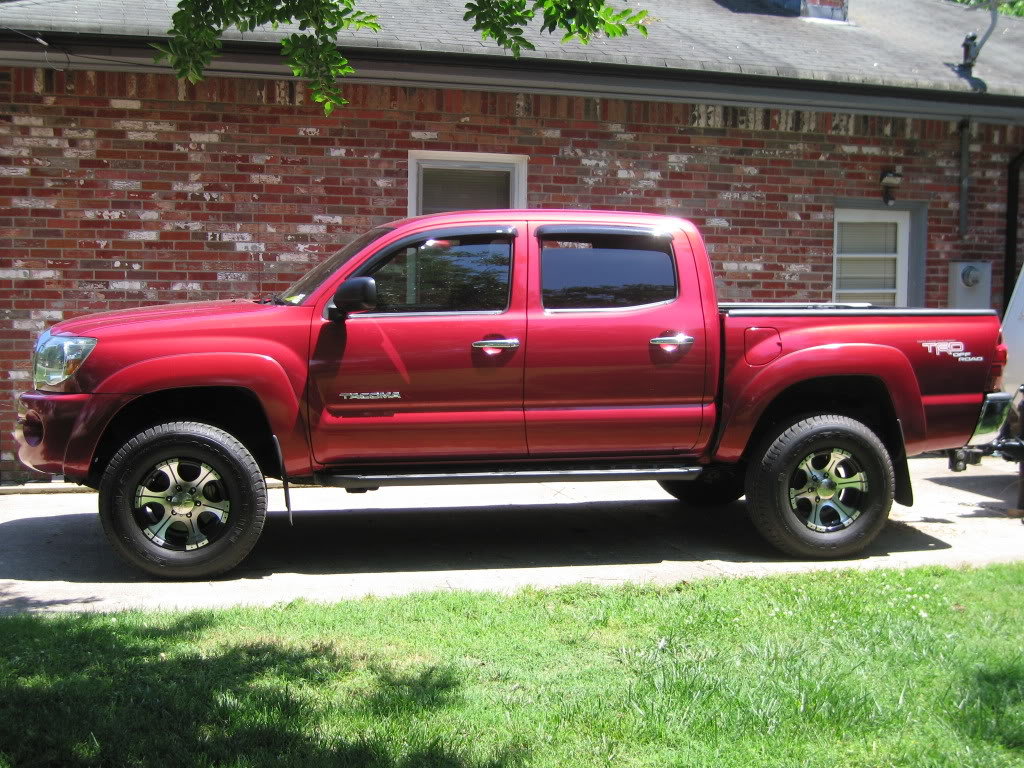

    I had the same problem when i lifted my truck. I had a friend do mine @ my local toyota dealer. I took it back up to him after i noticed it. I used the 5100's set at 1 3/4 and 2" blocks due to my camper shell. it was due to not droping the transfer case when truck was lifted. My buddy said it wouldn't hurt anything except u joints may wear out faster. I switched to 1" blocks and it fixed the problem. hope this helps
    Picture without shell
