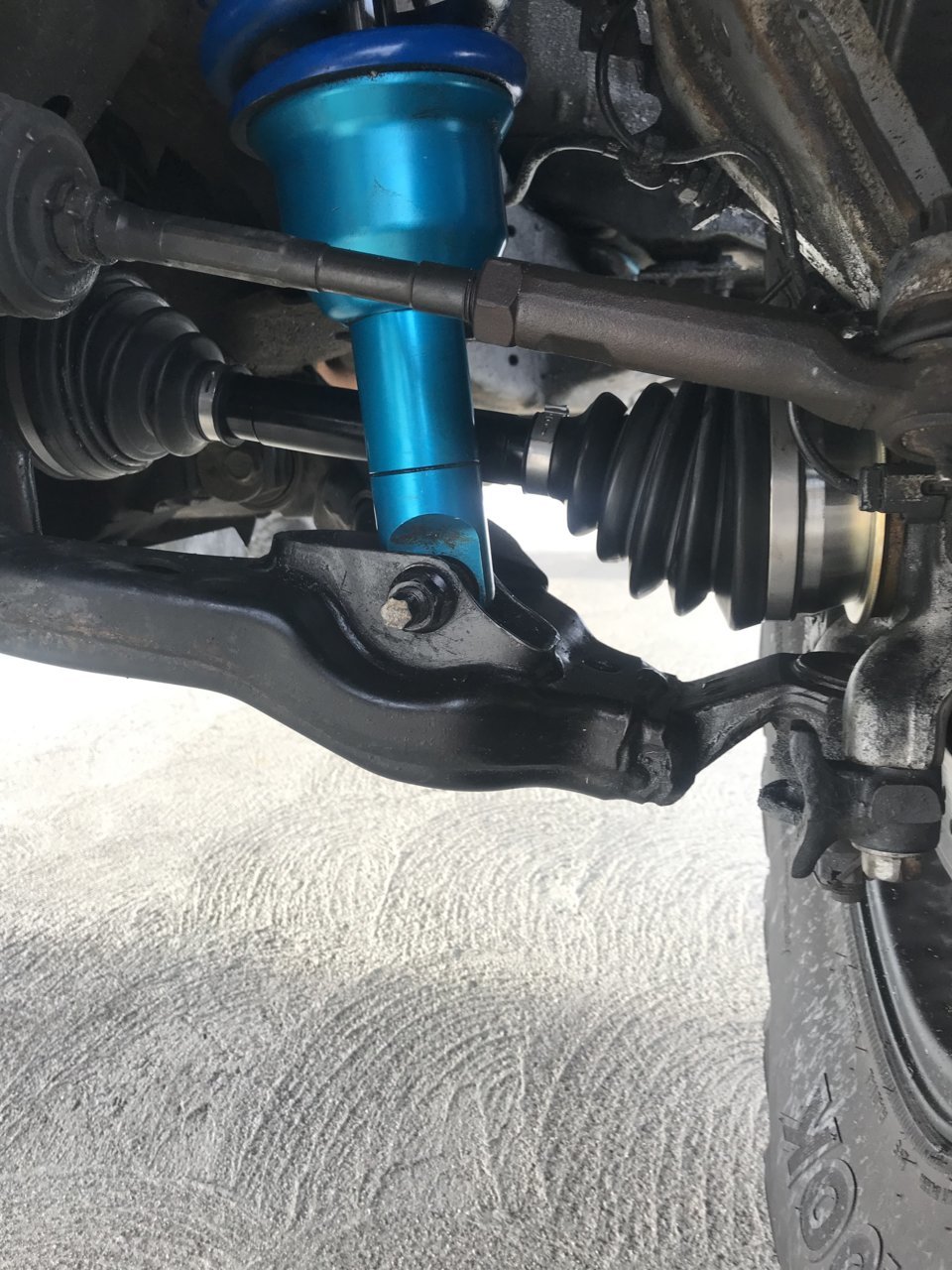

    Was just curious if anyone here had ever broken a cv axle from off-roading? I recently got some new ones from Napa and these ones are slightly different in design. I noticed the outer joint is slightly smaller than oem. The remans I had before looked completely oem. I do now carry a spare cv offroad

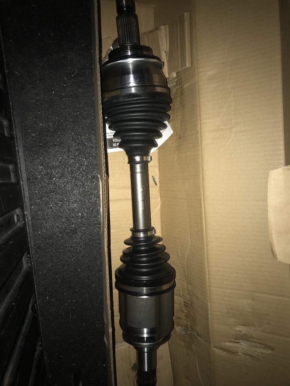

    My spare in a new cardone. The outer joint is larger 831ADBB5-7180-41BE-808C-EC5E5F74BEE5.jpg
