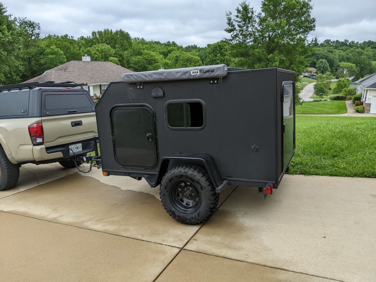

    Speaking of towing....I got a new camper in the spring/summer. It is from Tiny Camper. It is basically a hard sided tent with an axle under it and a closet. It's perfect for the kind of trips we like to do. Basically no set up and tear down and it gets you out of the wind and rain and dirt. I think it weighs around 1200 lbs. I get around 12mpg on the stock tune pulling it across the country at 70.

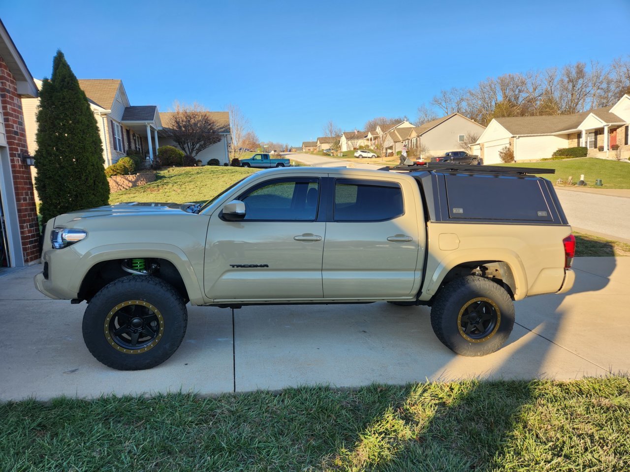

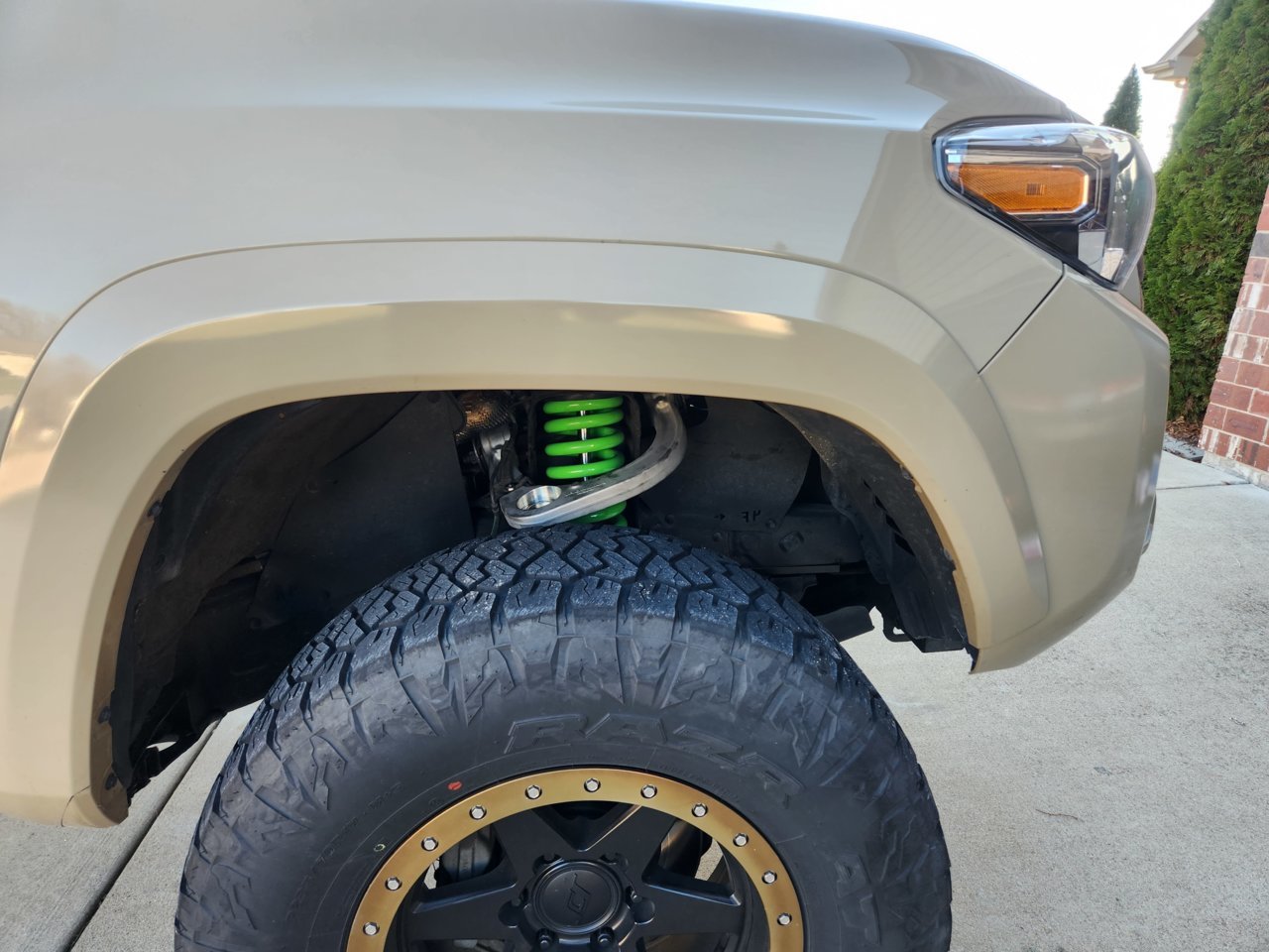

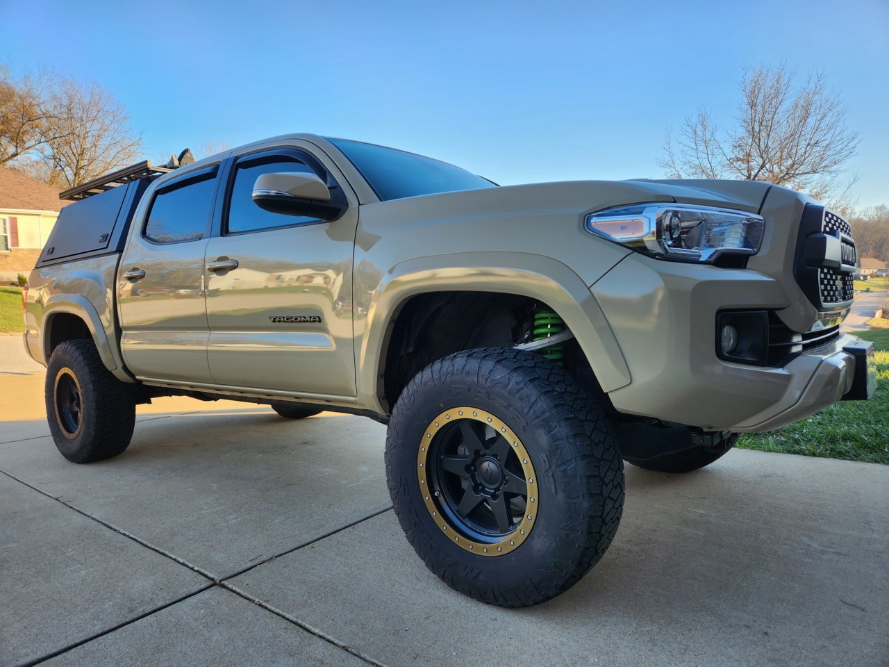

    20221125_152152.jpg 20221125_152222.jpg 20221125_152240.jpg 20221125_152255.jpg
    LIFT DAY!!!!
    I went with the 2.5 inch stage 2 kit from Iron Man 4x4. This is the lift I have been looking at for almost a year. If you read the rest of this thread, you have picked up on the fact that I didn't want to lift. I was actually really proud of the fact that I fit my tires without the lift. I just couldn't stand the way my truck would ride the bump stops every time I put a sack of groceries in the bed so a rear spring upgrade was needed.
    I picked this lift for a few reasons. The first reason was the factory style ball joint on the UCA. I have no desire to have to track down some wild proprietary thing ten years from now when it goes out. The second reason I went with this lift was the shock design. The high end fox/Icon/King/Radflo shocks require too much maintenance with a rebuild every 20,000-30,000 and the only real advantage is finer dampening adjustment that I don't need in the least bit. This design is a foam cell design that eliminates the need for high pressure nitrogen in the shock. This theoretically will lead to exceptionally long life and the ability to rebuild them easily in my garage. Another reason I chose this lift was the fact that the struts are extended travel. With the lift I lose about 2.5 inches of down travel but since the struts are extended travel, I make back a little over an inch of that back. Then finally, the main reason I went down this rabbit hole is the leaf spring upgrade. They are good from 0-400lbs extra weight according to the website. I figure I have between 250-300 with my topper, bedmat, and rack.
    I got about 2.5" of lift all the way around. The right rear is about .5" lower but the rest is even. That is way better than the stock setup. I had 1 1/4 inch lower in the back right and an inch on the front with that. I guess that means I got a 3.5" lift on that wheel.
    The install went pretty smoothly, but the UCA bolts are absolutely a pain in the butt. You hear people mention it, but it is really a kick in the stones. If I was going to start over, I would just buy two more bolts and cut the existing ones. Then you can put the new bolt in backwards. The only other problem I ran into was that I almost ran out of slack in my rear brake lines while trying to install the rear leafs. I was able to carefully adjust things and it wasn't a problem but I did manage to pull the connector apart for my rear locker before I notice I had a problem.
    I only drove about 5 miles before I ran out of time and had to stop playing around but the ride is vastly improved. I didn't bang off the bump stop going down the driveway. The body roll around corners is drastically reduced. (I did keep my sway bar). Brake dive was a big problem for me before and it is all but eliminated. The ride is hard to describe. When I hear people describe their ride after a lift, they always say it is firmer but in a good way. I always thought that was just a way of feeling better about paying for a crap ride but now I get it. The initial impression is that you feel more of the finer bumps but the ride actually is smoother because anything bigger than a pebble is soaked up by the upgraded shocks. It is way smoother on stuff like a curb because I'm not banging the bump stop.
    The truck pulls to the left slightly after the lift. I expected the camber to be visually off but it's not bad enough I can tell by eye. I will drive it around a bit so the suspension can settle and then get it aligned and try to post the print out.

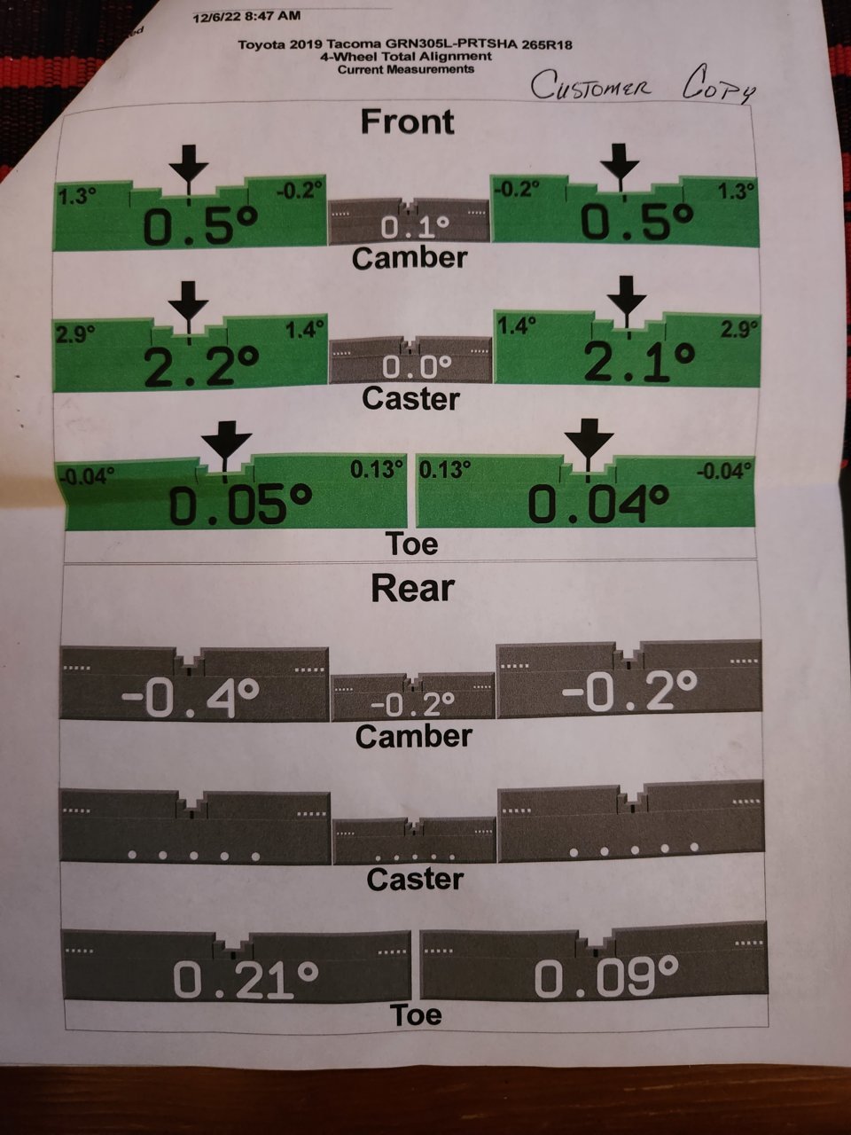

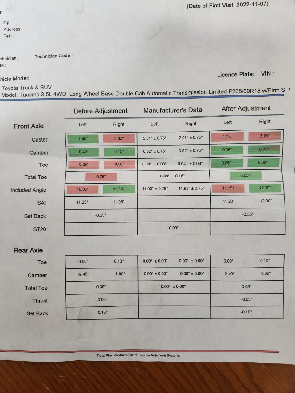

     I got my alignment done. The first sheet was an alignment I had done a couple months back before the lift. The second sheet is from today. I told the guy I wanted max caster up to 4. It didn't get there. The truck has a noticeable pull to the left now. I'm not sure why he couldn't get both sides close. I'm gonna have to find an offroad shop I guess

    I couldn't find a shop without a few weeks wait time so I went to the dealer. They wouldn't give me extra caster but the guy said I had plenty of adjustment left. The previous guy bent my cam tabs over adjusting the camber. It's ugly but I got that bent back. I hate having other people touch my truck. I have a cracked windshield that I won't fix because I'm paranoid they will screw it up.

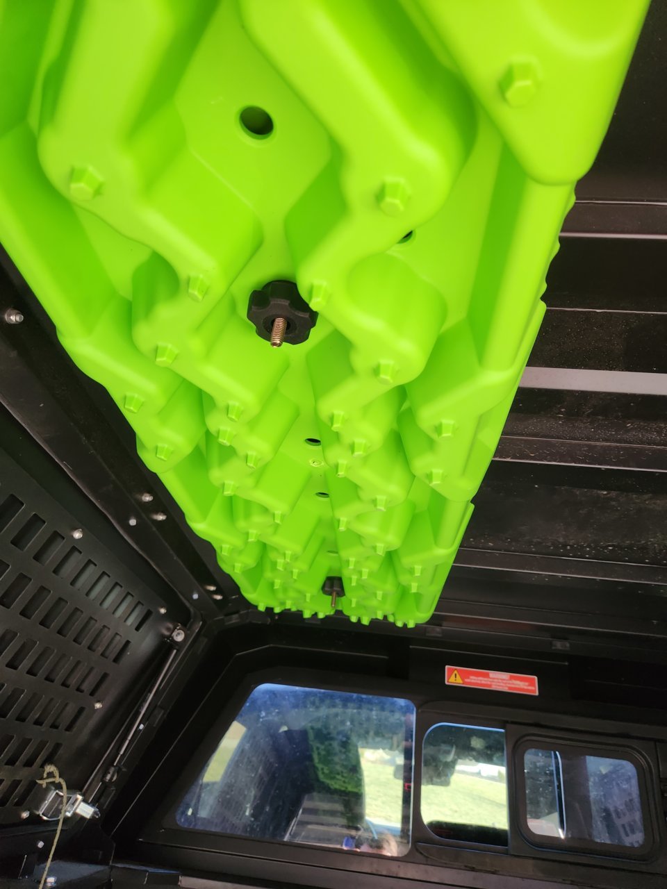

    Ironman sent some traction boards with my lift. I finally got around to mounting them. The smart cap already had prethreaded holes on the interior roof so I bought a couple of threaded rods and some plastic handles from Amazon.

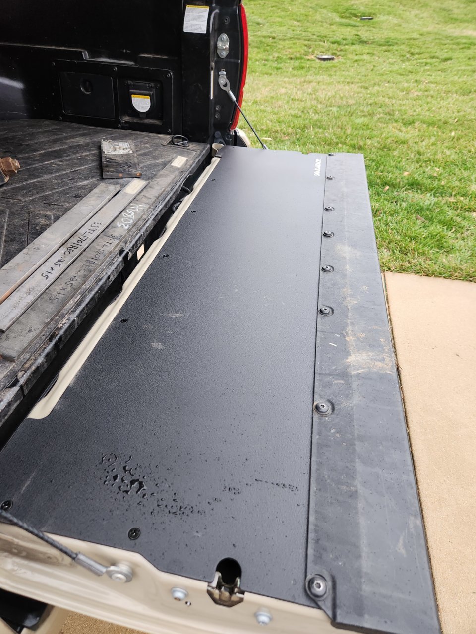

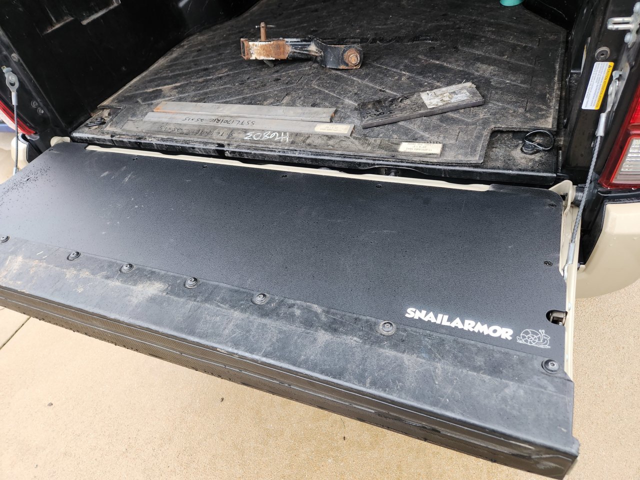

    20230311_165013.jpg 20230311_165004.jpg I ended up paying for something that I said was a ridiculous bit of flair that people with too much money pay for. I bought the steel powder coated tailgate cover from snail armor. I found a discount code that made it under 200 dollars. I was going to make my own, but metal prices are stupid high for individual pieces like that. Then I have to cut it and paint it. I was going to just use a plastic sheet, but that was going to be $90 and others have complained that the plastic warps in the sun. This came ready to rock with counter sunk hardware and I just decided to be silly and pay the money. It installed quick and it looks great. Now I can use my tailgate to cook on when I go back to Utah in April.

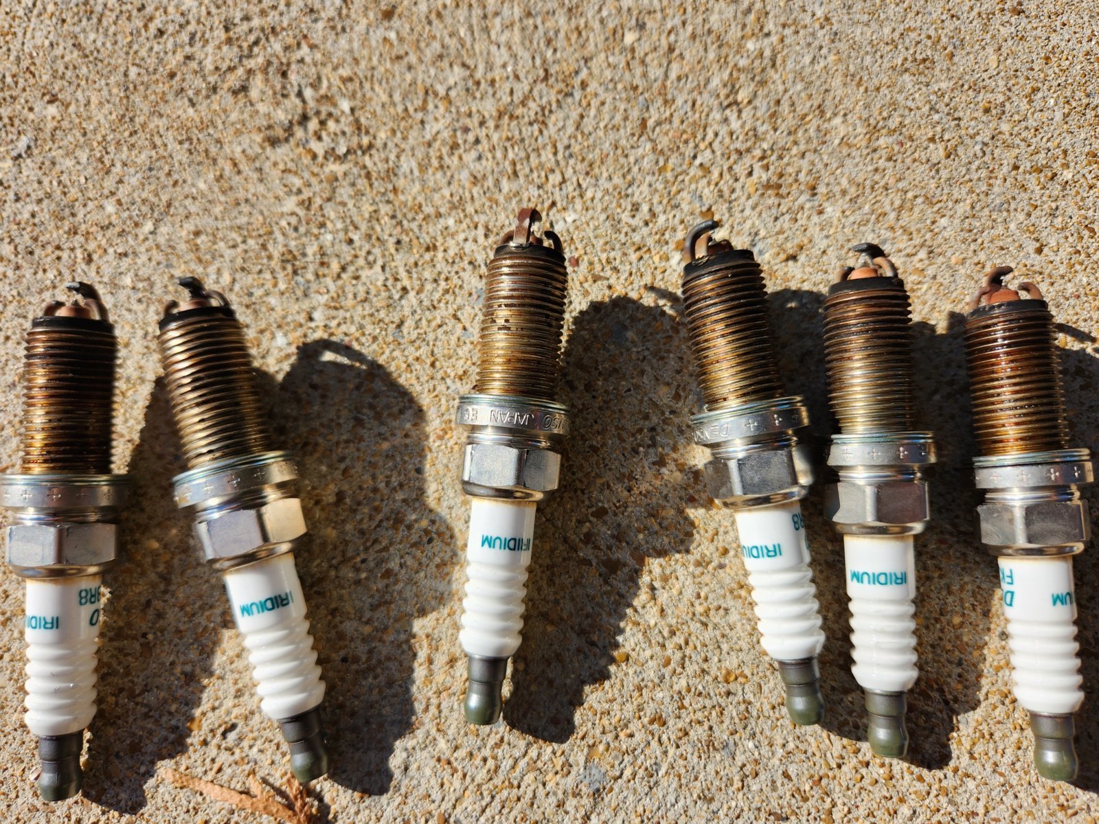

    Just hit 80,000 miles. Decided to bite the bullet and change the spark plugs. I followed the advice of many on YouTube and it took almost exactly 1.5 hrs. 1 for the driver side and 30 minutes for the passenger side. I used every one of my extensions and a pencil magnet to get it done. It wasn't bad at all compared to some of the 90s front wheel drive v8 motors I have worked on but you need a minimum of two 6 inch extensions and two or three shorties.
    I didn't expect to see any change but the truck does seem to be smoother than before. The manual says 60k miles and I stretched it to 80k. I suppose my 4.88 gears should have shortened the interval also since I rev higher. Anyway, here is a pic of the plugs. 20231128_123023.jpg
