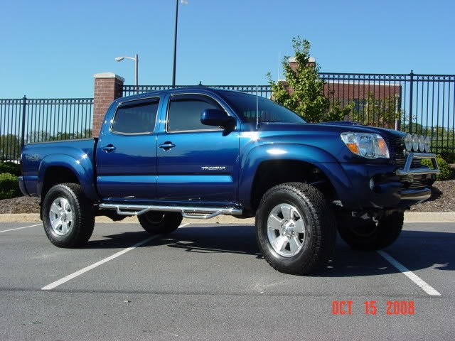

    this is the pic of my truck on their website the day after i put it on.

    I have that kit;no problems;20k miles & ball joints are fine.I am 2wd & rarely go offroad & if I do it's just light trails.I also am very anal about the upkeep on my truck.Anyone serious about their truck & wheelin it would do their homework about suspension lifts and go with quality coilovers instead of spacers to reduce damage when wheelin.Spacer lifts are for looks & the street & can be done right.There are some who bash them,but they were either installed improperly or abused & used for the wrong purpose.

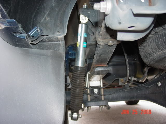

    I have had no problems.I also have TC UCA's,285/70/17's,& 1" block in rear w/Bilstein 5125 extended length shocks,and Spidertrax 1.25" wheel adapters front & rear.As I said b4;don't use this lift if your going wheelin;spend the money on quality suspension components.
    DSC02548_39df765589bca5e53d702d82bc71e98d1e8eb8cc.jpgDSC02551_d2e3c44cfbc49bb3c026f576671a3d158de5bc29.jpg

    Hey buzz. Is there any particular reason you chose to use a spacer lift? I am just asking because it seems it wasn't a budget thing so I am curious!

    dont think that top rear shock mount is in the right position. maybe turn it 90degrees.

    Yep. That what I was thinkin

    buzz5 those rear shocks r upside down man.they go that way on 1st gen.someone correct me if im wrong.

    Nope. Your correct. His shocks are upside down, and, From what I can tell, his coils are not mounted on the shock correctly.

    its amazing he hasnt had any problems with all that with a spacer on the billys

    ?? about the shocks/coils not being right?? Blue is up on mine- Is there something else I'm not seeing??
