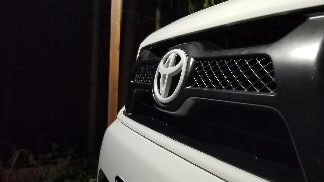

    Just painted my toyota grill emblem, was wondering what you guys may have painted yourselves regarding your tacoma.

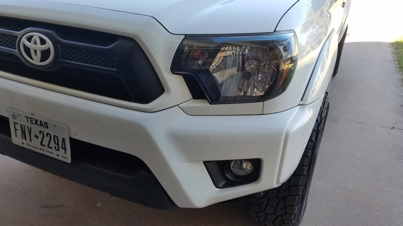

    If you are just asking about paint specifically I've done the front Toyota emblem, my rear differential, and my battery tie down.

    That bumper though, paint looks good to me.

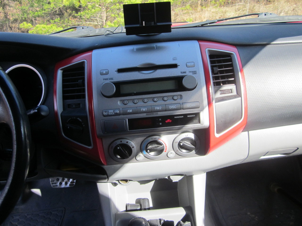

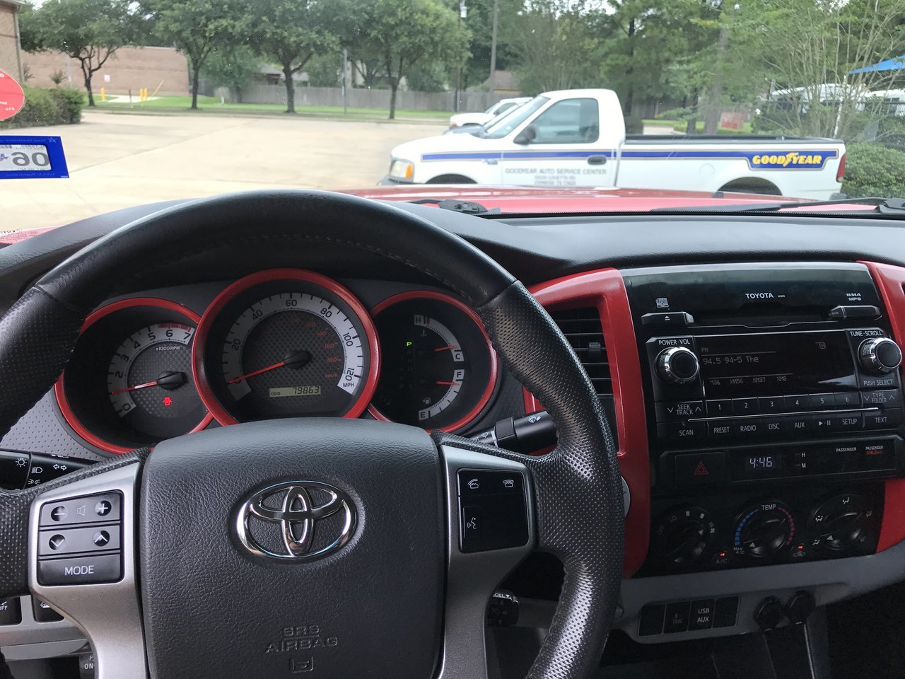

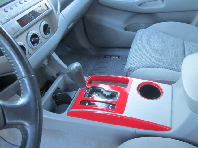

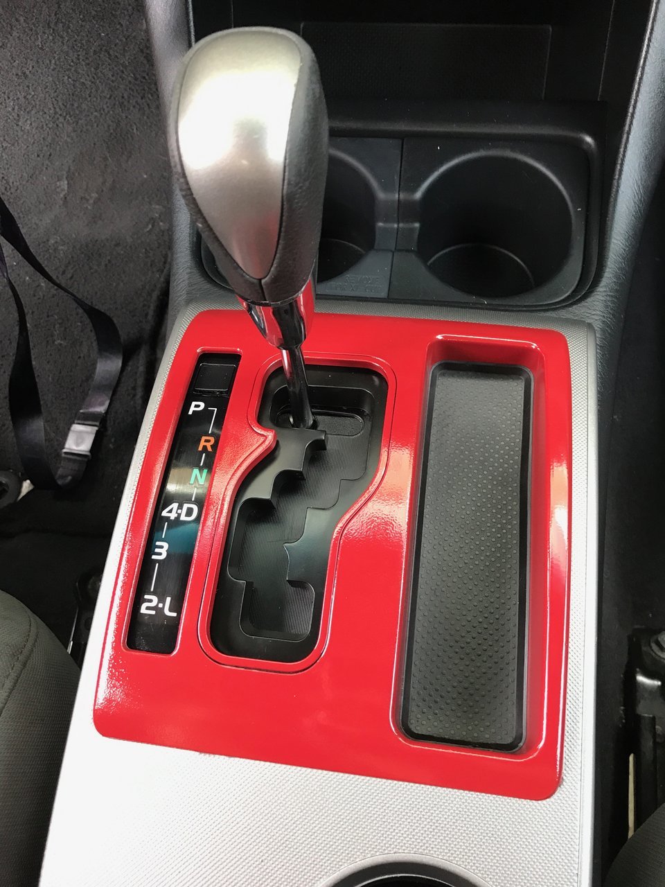

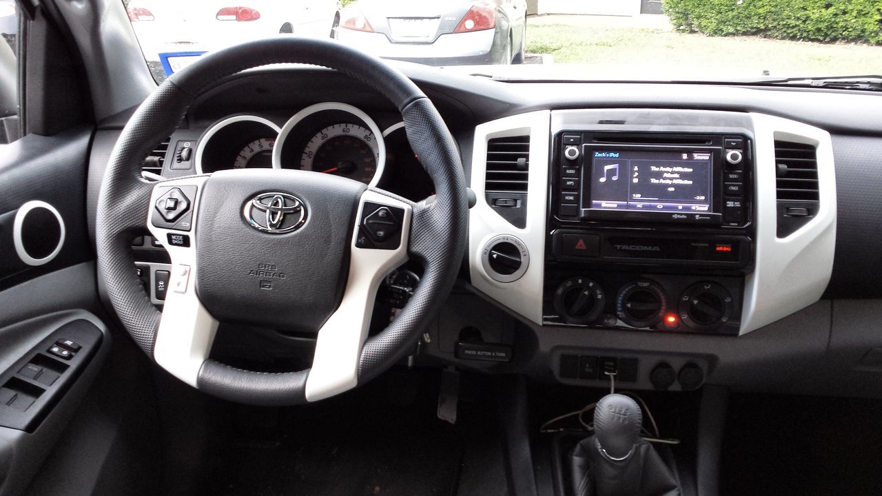

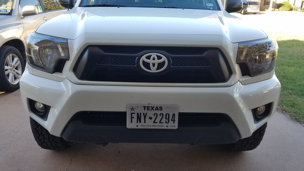

    Grille/emblem
    Headlights
    Dash trim
    And painted my emblems black

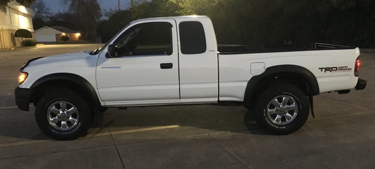

    What kind of paint did you guys use on the interior? I painted Both bumpers grill Pool Table , Emblem is gunna be white in the morning !! IMG_1307.jpg IMG_1658.jpg

    What kind of paint and preparation used for the interior parts?
    How durable?

    Rustoleum colonial red for me. It's been on there for roughly 6 months. Works fine. Fine grit sandpaper. White primer and hit it with 2 coats of red.

    I used the duplicolor perfect match for everything. I did it 2 years ago and the interior still looks perfect except some minor chips around the edges of the cup holder (from me letting random stuff rattle around in them). Just sanded, primed and sprayed 3-4 light coats of top coat and and 2 light/1 medium coats of clear.
