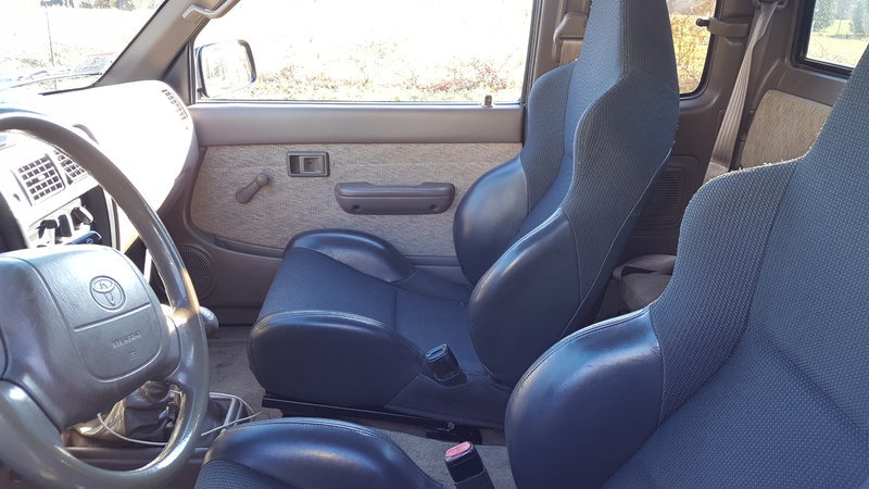

  18. Dec 21, 2016 at 5:39 PM
    #18
    Pumpman
    Pumpman Well-Known Member
    Dec 20, 2016
    #205310
    128
    Bert
    98 tacoma sr5
    Srt4 seats i love them super comfortable
