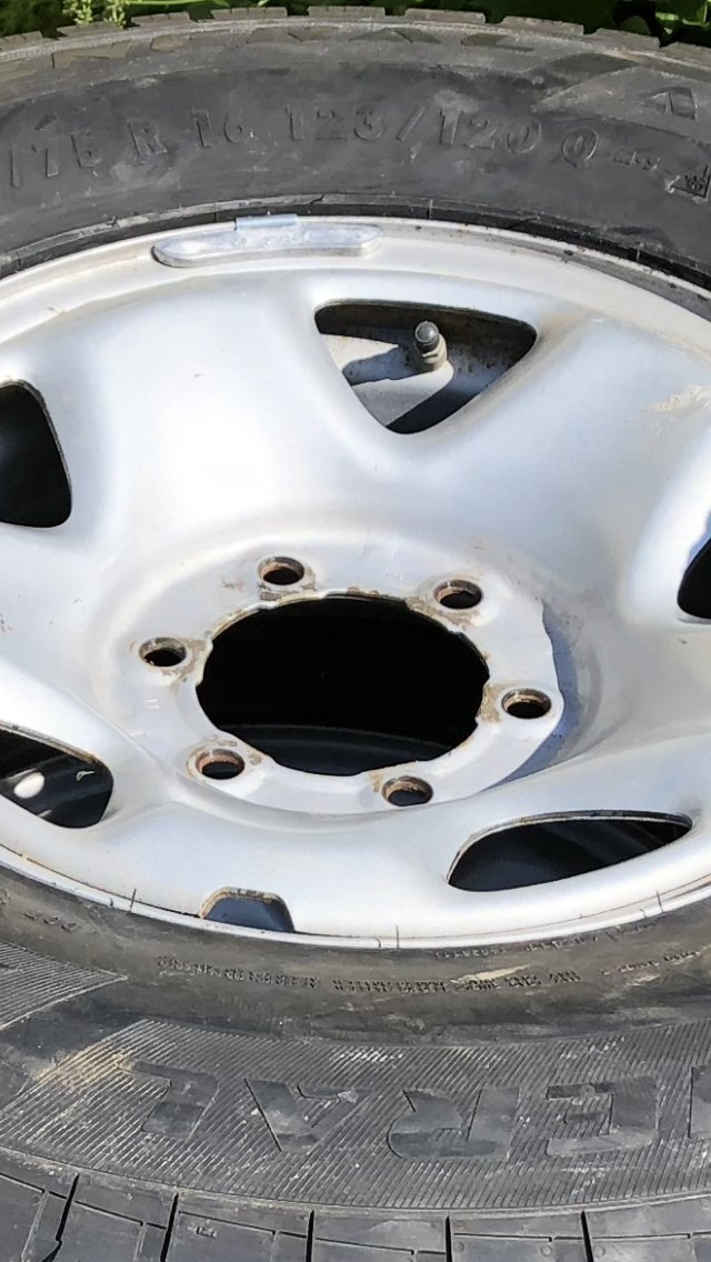

    You can see the center bore is too small on your wheel.
    Our wheels have a much thinner wall thickness between the OD of the center bore and the bolt pattern. They would fit gm.
    See how the center bore is a lot closer to the bolt pattern.
    There should be markings on the inside of the wheel google them that should give you their true specs.

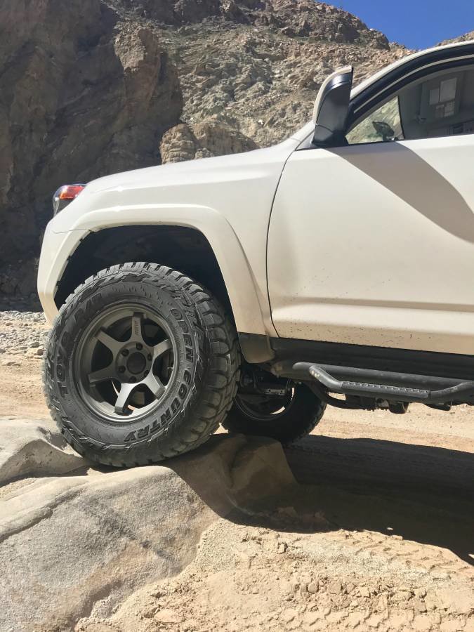

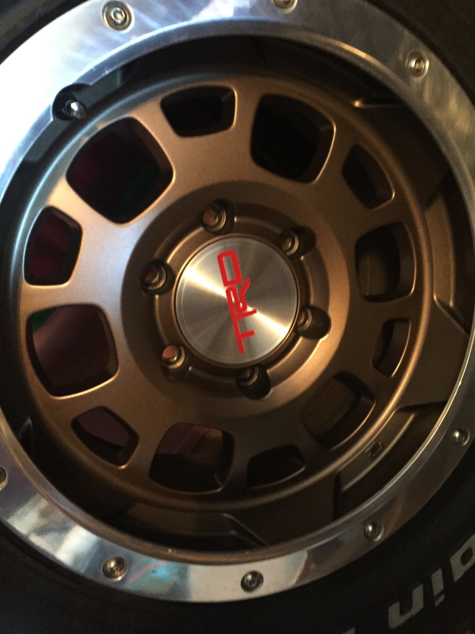

    Does your dust cap look the same as the one in the 2nd post? It looks like there is a decent "step" to the dust cap in that photo and that might allow it to clear. Or are your rotors too thin and don't help push the wheel a little farther out? Are they stock Toyota rotors?
    The picture of the 4Runner on their site looks like the same size opening.

    Yea, it does look the same, the hub/dust cover in the 2nd post, and the opening in the pic of the 4runner.
