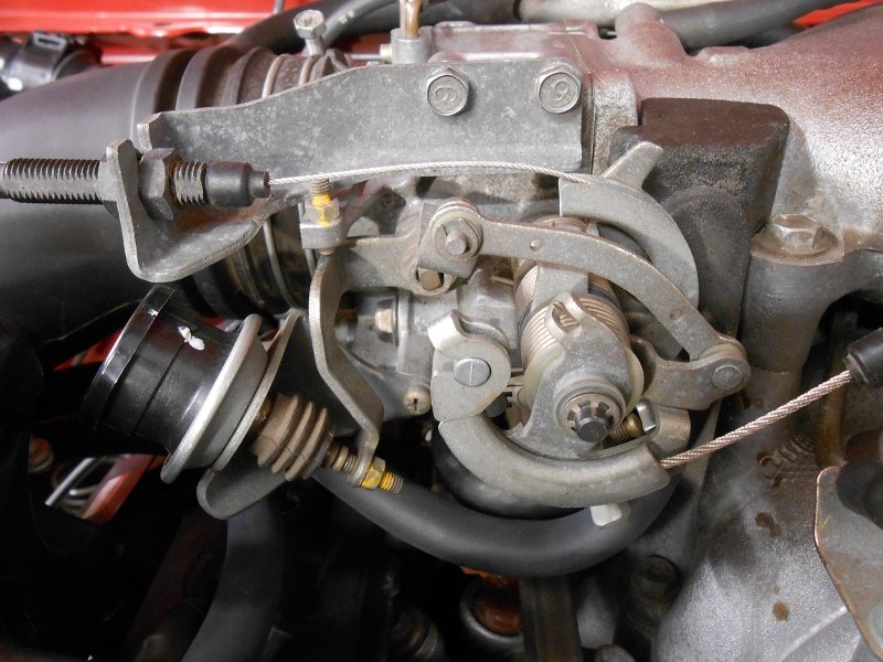

    1 thing that attributes to this is the dashpot.
    the black capped thing with the white mark on it. i dont know what its really for, but it's a dampener. when you let go of the gas/throttle, it hits this dashpot, and the dashpot slowly brings the throttle arms to a rest at idle.
    aside from this. I think this is completely normal behavior for our trucks.

    i think the dashpot is only on manual transmission trucks. that way when you change to the next gear and let the clutch out, the motor is more in sync with the revolutions of the clutch than it would be if it was at idle.

    It closes the throttle plate slowly so that the engine won't run super rich for that split second. It's to reduce emissions.

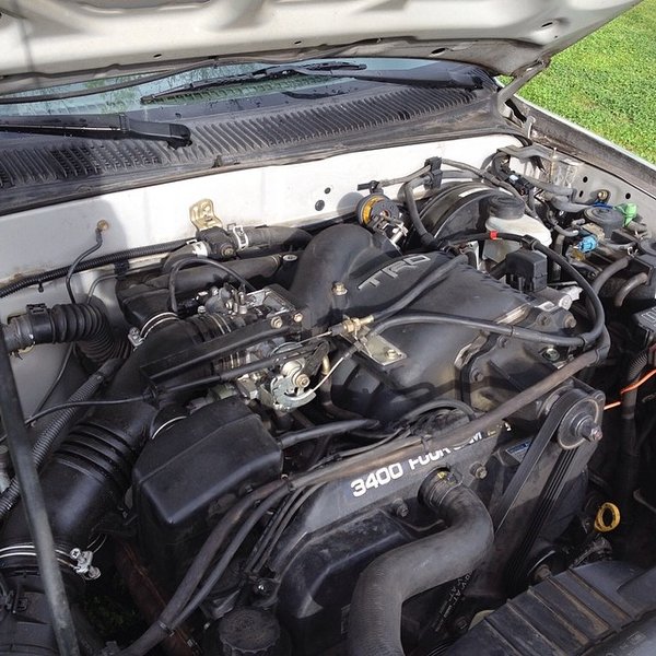

    I actually had this issue before. I got a different cruise control but the pin that holds the cruise control wire on the throttle body was holding the throttle body, I had to give my truck some more throttle for it to stop. Basically had the same issue as OP. Might want to check that out.
    Here's some pictures might be hard to see my cruise control computer but its there.
