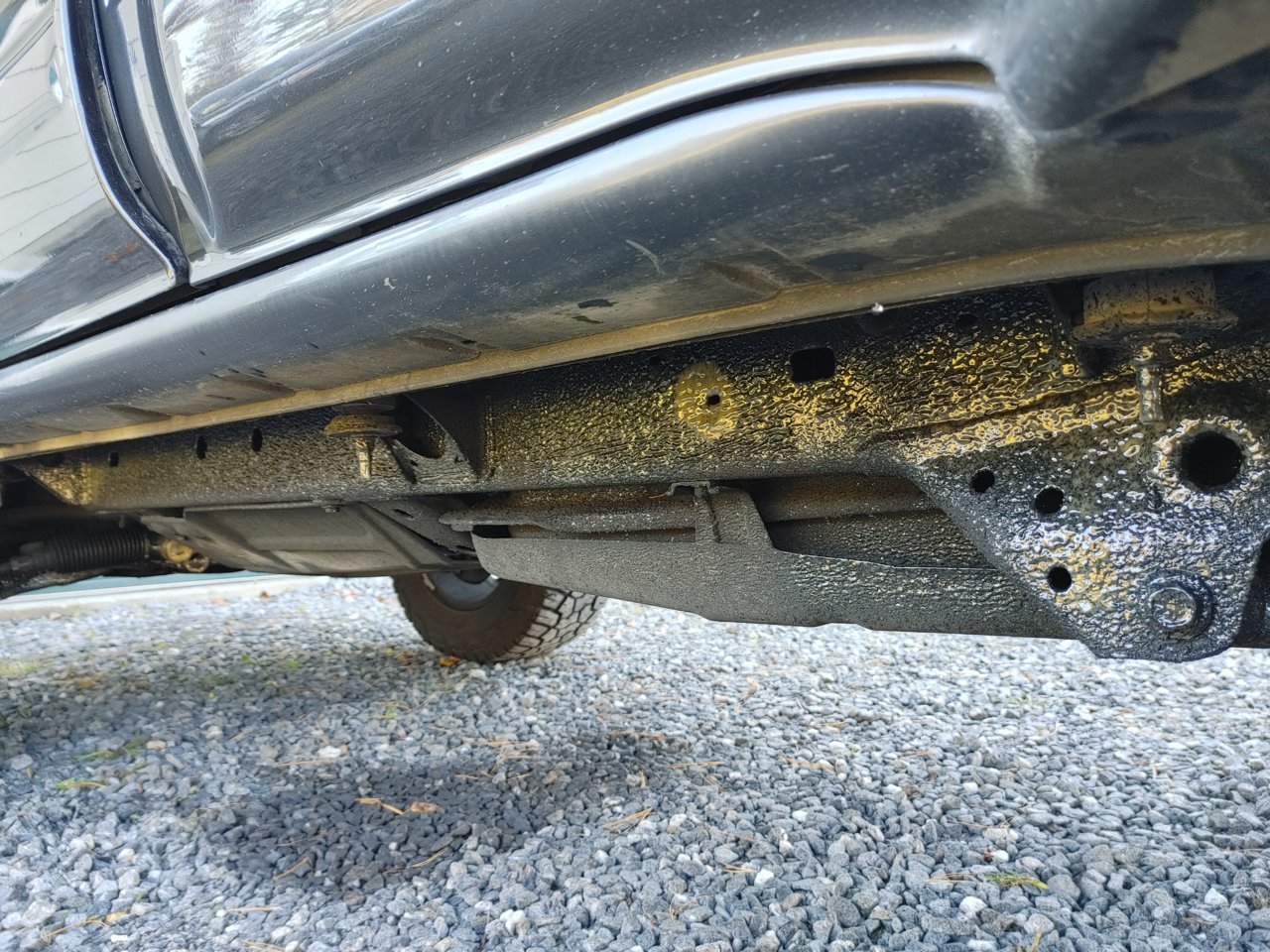

    My point was that that video is BS. You can clearly see it was applied over rust many times over. Also, that’s not vulcanized rubber.
    When it’s prepped and applied professionally to a brand new vehicle, it works.

    Like I said previously, my frame looks mint after almost 5 years

    I can't say anything about the diamond kote coating you used, but looks can be very deceiving.
    I had a coworker with a second gen that the dealership sprayed with some black coating. It looked great and just like the frame was brand new... Until it started falling off one day. In a very short while the frame went from looking brand new, to looking like the truck shouldn't be driven in a very short while due to the coating hiding the rust forming underneath.

    The advantage of cosmoline and fluid film is that they flow when damaged so that they self heal. I took your statement of "active coating, such as fluid film, cosmolime etc." to mean that diamond kote was similar behaving to those coatings. Perhaps I misinterpreted what you meant.
    Either way, that MSDS sheet states that the diamond kote is nothing more than tar and not vulcanized rubber. If they are lying about tar vs vulcanized rubber in their sales pitch... I would find the "active" claim highly skeptical as well. The MSDS sheet certainly doesn't indicate anything that would make it "active".
