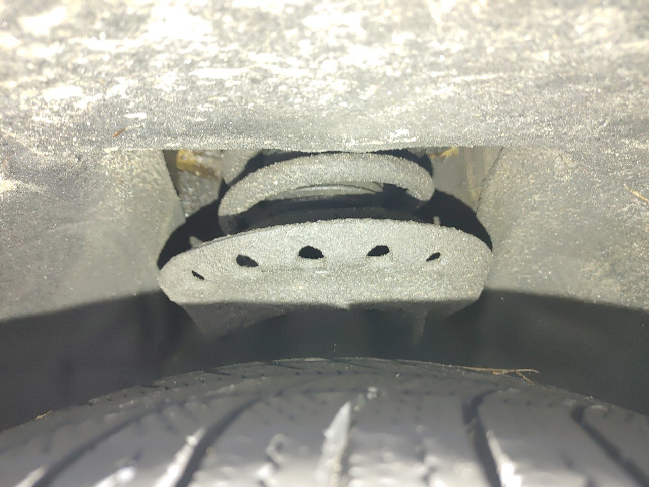

    Fwiw, I did my winter car with it back in November. It's been the wettest and saltiest winter I can personally recall here in VT, I'd bet the roads have been wet 80% of the time since I coated it. I do a minimum of 50 miles a day with it, and even in the highest water spray areas like here, it's still just as thick as when I sprayed it on.
    I can't recommend the stuff enough. It's amazing so far. But like FF, it does help significantly to get a layer of dirt built up on it though
