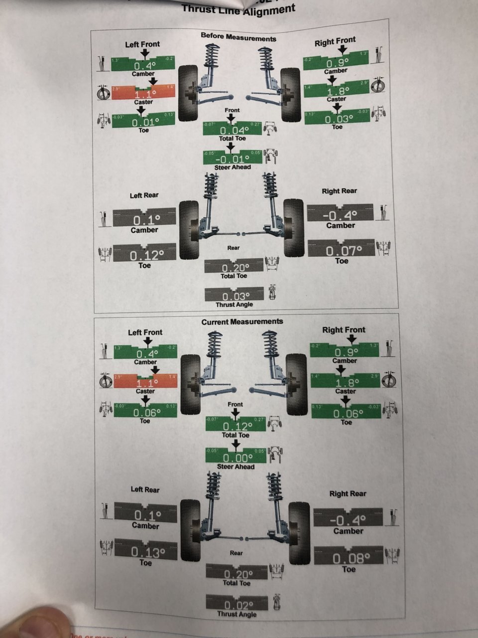

    Alright, I need some help. I have a 2018 Toyota Tacoma with 35k miles. It has a 2.5 inch suspension lift from Fat Bobs Garage w/SPC UCA's. 265/75 R16 on stock off road wheels. Tires are Cooper Discoverer AT3
    Here are my issues:
    Half the time looking straight at the front, the camber is clearly positive, by quite a bit, but other times, it's dead on. Why? I've had the alignment done 3 times in the past 3 months, still the same issues. The front tires clearly have uneven wear on the outer edge, but its not crazy bad.
    When I turn, its almost like my entire truck slips and either wants to jerk one way or the other, this also happens on bumps or any road imperfection.
    Lastly, when I drive on the freeway(or any area) with the grooved concrete, I have to deathgrip the steering wheel so my truck doesn't just randomly pull to one way or the other. A word I would use is squirmy.
    I can't figure it out, any help would be much appreciated.

    @memario1214 According to the sheet they give me everytime, it is dead on for factory specs

    Post the alignment numbers.
    Factory spec or in the green can be way off.

    Toe and go... alignment sucks.

    @splitbolt What should I tell them to set everything to?

    I'd go;
    +2.4 caster
    +0.5 camber
    +0.05 toe

    @splitbolt and you think this will fix the issues I have been having?

    How is your Aligner ??? Good with lifts and Tacoma?? Perhaps you should try another recommended alignment Shop ?? I don't know enough about the alignment machine to help .... but I just wonder how accurate the machine was .... i.e. The alignment machine is out of spec ... JMO

    This is good. I’d even have them push caster as positive as they can get 2.5-3.0. Also set in this order. Caster , camber , toe. Good luck

    How can your caster be below 2 when your running SPC UCAs...the ball must be indexed wrong....got a photo?
