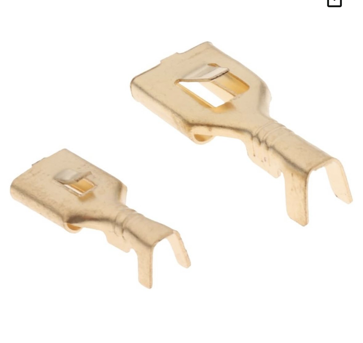

    Can’t tell from the pics but could be the locking table or the terminal opened up and is loose. You can de-pin to verify. There are many types of pin styles so it may be different than the one below. Most manufacturers sell the terminals, if not you can match up to aftermarket. It’s easy to crimp a new terminal on if the locking mechanism or terminal has failed. Even in a disaster scenario you could buy a aftermarket socket and relay and splice it into the factory wiring and zip tie it next to the fuse box or on a harness. Many cheap ways to do a repair to get your truck running. If I was local I’d help
