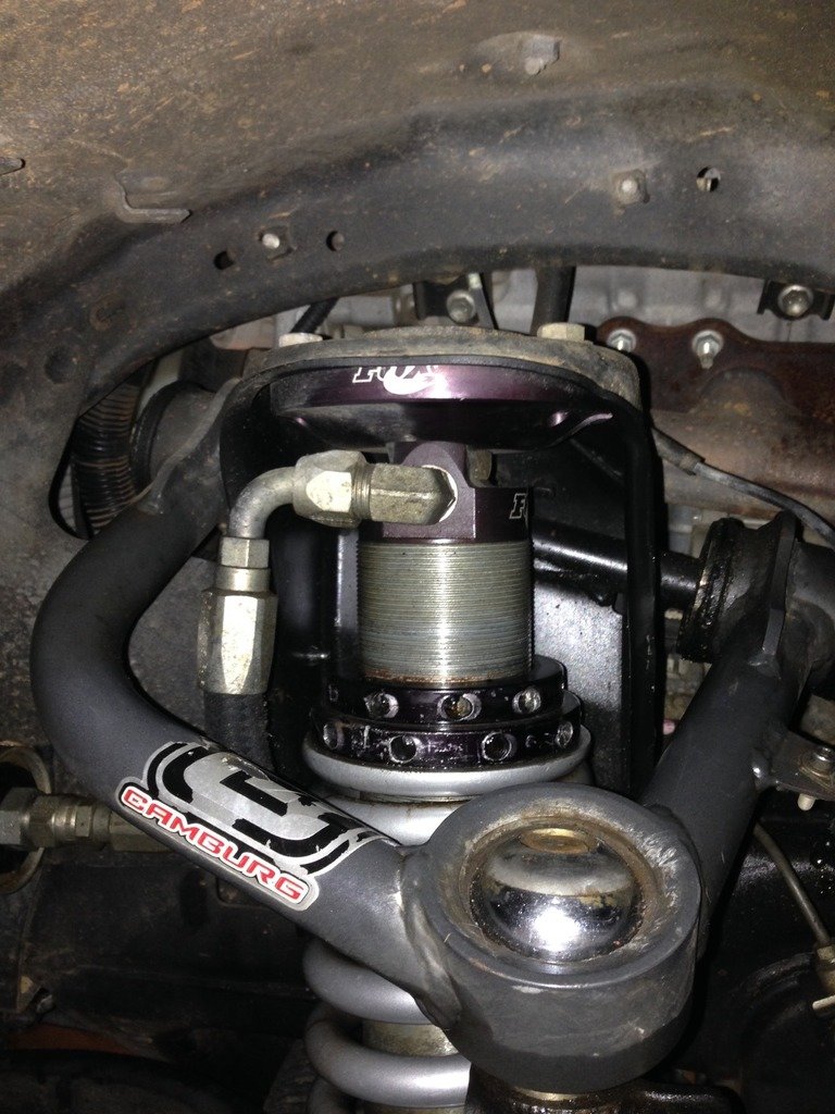

    Hey guys I recently put a Dakar leaf pack in the rear of my truck and was attempting to raise up the front level.
    I jacked up the front end of my truck as recommended and I have encountered 2 problems:
    On the drivers side I was able to turn the adjustment collar down almost a full inch, as in I now have an extra inch of threads showing than before I started. I took measurements from wheel to fender before and after starting this and I only gained 1/2 Inch of lift, it went from an 8" gap to a 8.5" gap. From all the research I've done its supposed to be a 1:2 ratio from (threads: actual lift) and I am getting a 2:1 ratio, which is blowing my mind simply from a logical perspective.

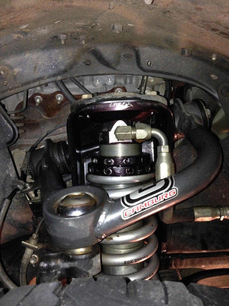

    On the passenger side I can't even get the top ring/ collar to unlock.. I even sprayed hella PB blaster on it a day in advance at the top and bottom of the coilover. I'm a fairly strong guy and I actually bent the punch I was using just trying to crank open the unlock collar (yes I was turning counter-clockwise also)
    Drivers side pic:
    Passenger Side:
    Despite the thread difference wheel to fender is only Half an Inch more on the drivers side. Hub to fender on drivers side is approx. 23" and it's still no where near level with the OME leaf pack lift on the back. I called Fox and they did try but where basically no help...
    Anyone have any suggestions or recommendations? Experiences this before?
    PS- The fudged holes in the collars are not from me but the previous owner
